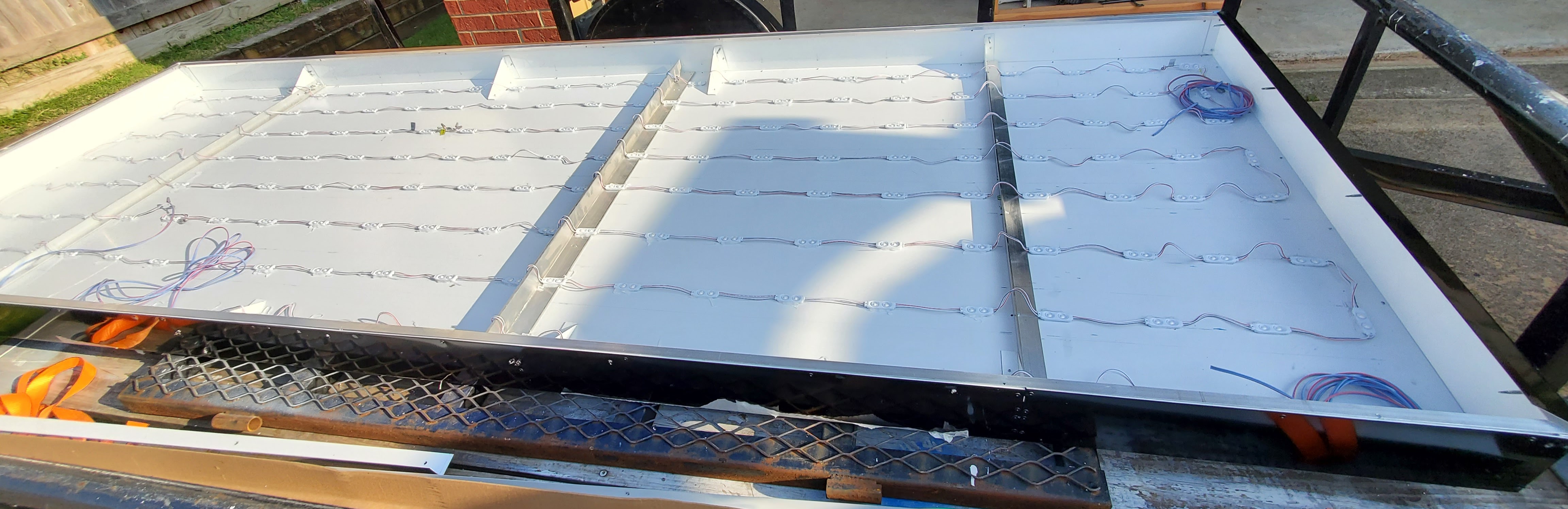

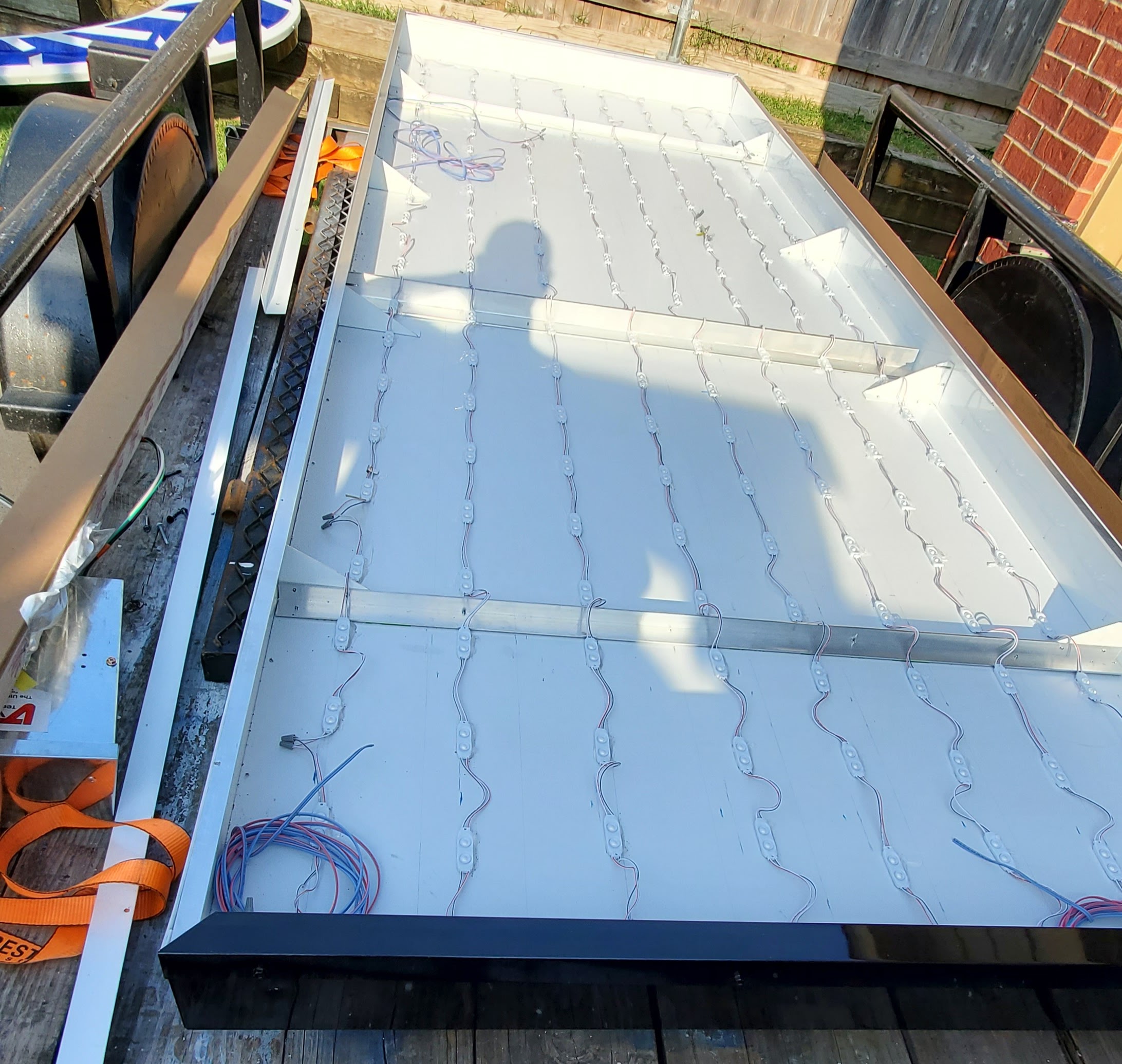

I usually wholesale my cabinets to a company in Alabama and have been pleased with them. Earlier this year I installed a sign for another sign company who bought from a local manufacturer. I was impressed with the build quality and asked them to build a lighted cabinet for me. Well, I picked up the cabinet yesterday and I've never seen anything like this. The entire cabinet is so flimsy it feels like it's about to fall apart. It flexes so much under it's own weight that I feel like it's going to break.

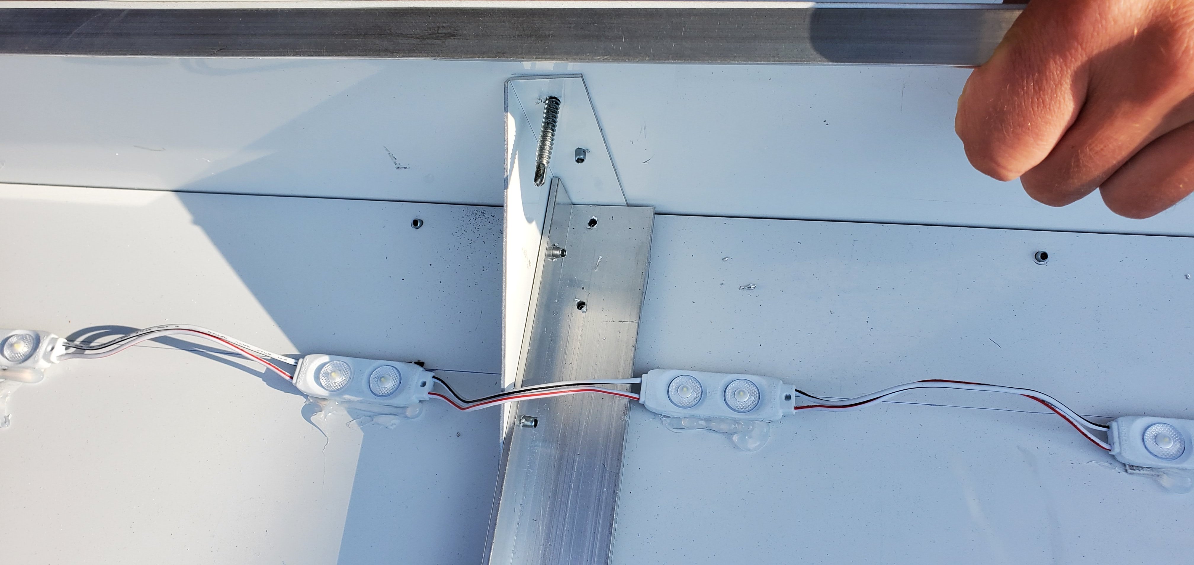

The backer is 3mm ACM. The side walls are bent 063 I guess? They are riveted to the ACM. There are three vertical aluminum angles that feel sturdy but serve no purpose because nothing is attached to them. There are bent 063 or 040 aluminum brackets with ONE rivet each holding the side walls up. (I put the screw in it) The "retainer" is something thinner than 040. The inside angles that go all around the sign that hold the face in place are .75". You can't put a face in there without it popping out. It flexes so much that it's just a feather touch away from all falling apart.
Has anyone see something like this before? Am I trippin over this thing? I don't feel comfortable at all putting it on the wall with my sign in it. My sign face is probably twice the weight of this entire "cabinet"
