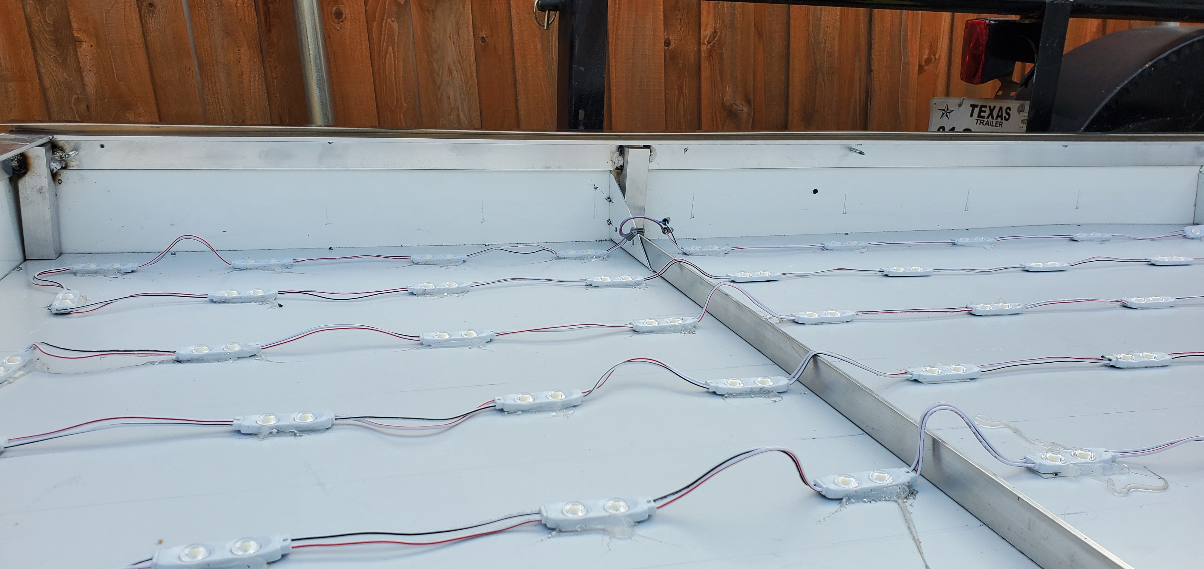

Is this REALLY how a sign cabinet should be built?!
bowtievega
Yikes. If there are multiple sign sections that house electrical components that aren't assembled together at the manufacturing facility then each section needs a UL label. Are rivets so expensive that it prohibits someone from using enough lol? They aren't sealed rivets either.
Billct2
I've seen wall signs built that flimsy but once they are fastened to the wall they are Ok. Still wouldn't accept that cabinet, multiple issues besides the build.
MikePro
that's a fairly well-built, cheap sign. lol
looks like someone loves rivots, and realized how cheap it was so they dug up some self-tapping screws around the shop to "beef it up".
...no way I'd put that up with my name & insurance on it tho'. bet the whole retainer flexes in the wind and pops the face right off onto someone's car.
Texas_Signmaker
Very Active Signmaker
That's what I was worried about. Maybe it would flex less once the whole thing is installed but my gut says this wasn't a good idea. I usually lift the cabinet up with the face in it (just slid out a little so I can both either end) but this thing could barely hold itself together, let alone a face.
They are building a new cabinet today with framework and should have it ready for pickup tomorrow morning. We'll see. I've never seen a cabinet so cheaply made... and I've seen a lot of signs.

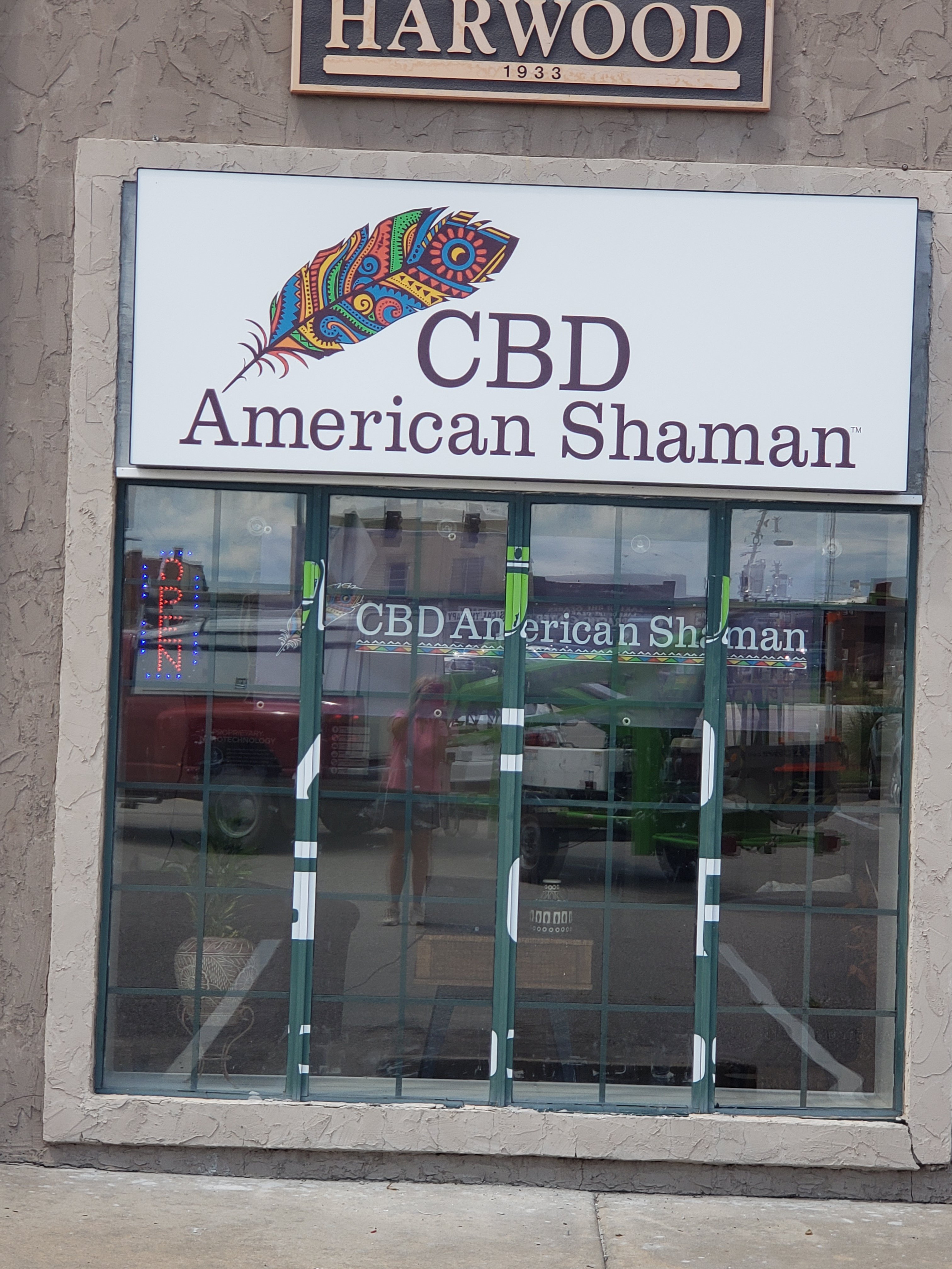

That actually looks a lot like some indoor signs we installed for a cable TV company's retail store. They were very flimsy until they went on the wall. Being that they are indoors it seemed sturdy enough for the use. I wonder if they accidentally built you an indoor cabinet.
We've also ordered cabinets that were built like a channel letter, which means the face is visible almost all the way to the edge of the sign. Kind of weird, but it makes an attractive sign. They are quite sturdily built though.

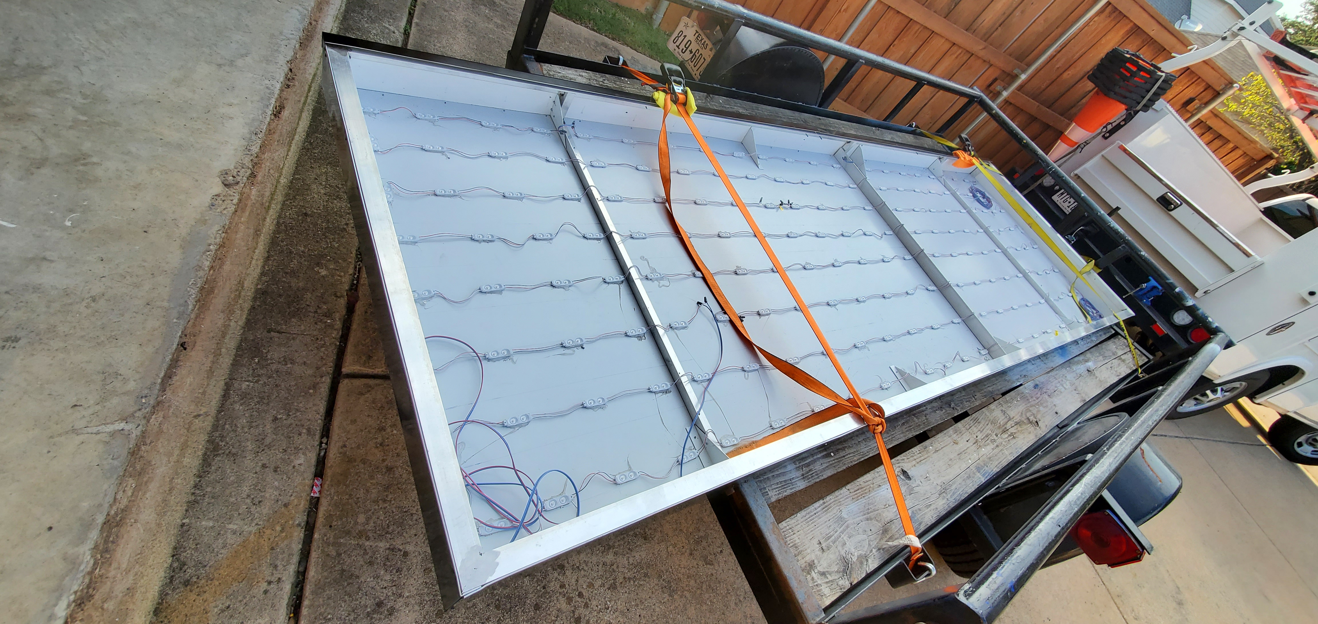

I've seen SMALL cabinets built like channel letters but not a 4'x12'. I just picked it up and it's much better. Aluminum angle and tubing frame welded all around it. They don't know how this left the shop, apparently no one checked the new guy's work.

Its much better now. There is a welded angle fram all around the sign, and welded tube to the angle on the back. Now the thing is structural and has no flex when mounted. They still forgot UL label but Im swining by tomorrow morning to have it put on because they had them locked up by the time I got there this evening.

I know, I'd rather it was built differently but this will hold up I think. I would of rather the side walls be solid aluminum U channels, maybe 5" x 1.5" or something, welded together with a few angle in the middle.
It certainly feels much better and once the angles on the back are secured to the wall the entire frame does not flex at all.

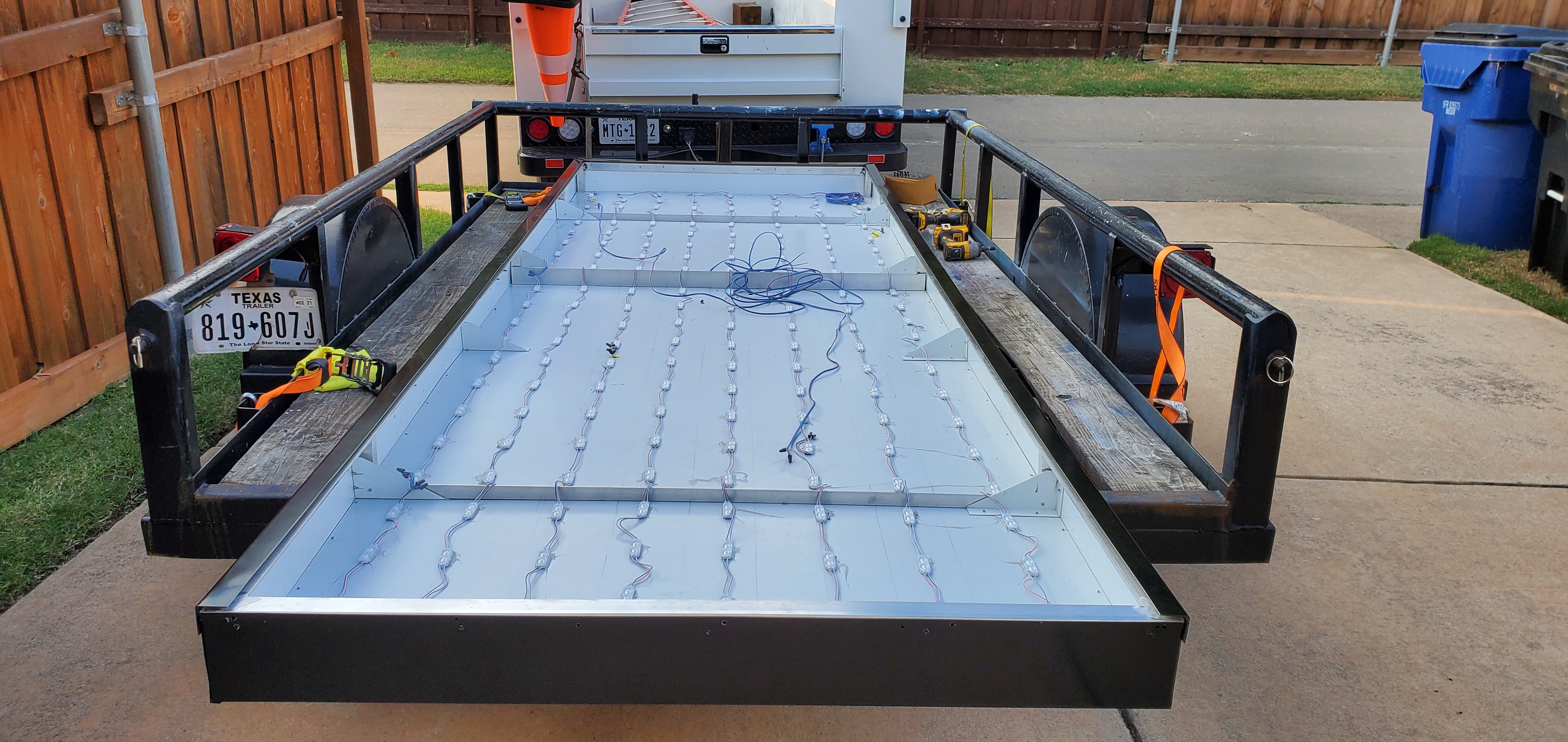

Here is a view before I put the retainers on it.

Well, apparently there was miscommunication. They gave this project to the guy that builds channel letters and they told him to make a 4x12 box. He thought it was going to be a trim cap face. He wrapped it up and no one ever checked it before going out. Makes sense because it was built like a channel letter.
