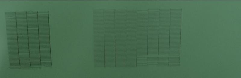

Thanks that was driving me nuts..But this is what Iam getting on test print no cyan or yellow at all. Have new cap on capping station,didn't replace the station just caps...have not replace pumps yet

bad pic Ill try again bigger if not Ill take a pic tomorrow out side in the day light

it was hard to tell with the photo what channel was what. just a cap top change out is fine enough to diagnose whether things are working or not. did you do the quiet room listen for hissing air noise? the ink supply will make noise when it is leaking. also, as far as seal, you can have a partner push up temporarily on the bottom of the capping station to really force a seal, and then pull at the waste line. if it seems that one pump is working and one is not. you can do a pump tube swap, and let the "good" pump pull on one or both foreign lines. just switch to the opposite pump if doing a head clean.
when things get odd it's usually good to itemize in a list what you did and what from that you know it can't be. there will be tons of print shops on line tomorrow and the clearer things are to follow, the better. have the empty spaces ever come and gone? that is important. to me, it looks like the printer ran out of ink on a few sides. we know that's not it. if a blank side comes and goes. that's data. don't worry about ink supply. if a blank side gets some lines or portions here and there. that's mechanical. before you can "know" what it is you have to know what it isn't. and never look there again. btw. i'm up all night finishing a project that is due tomorrow. i had an encoder sensor go out friday which bumped this thing into the impossible zone.

Well did data swap and the new head fired on all cables the black just changed to other side or channel. So that means all the heads I got from digiprint were no good.Plus black has lots of overspray,Still nothing out of cyan and yellow.Like I said they sent me one that had a part moving on the inside..it rattled every time you would move it.I always heard good thing about digi. I must be the one they needed to unload them on ...well just have to laugh it off and keep on rolling
