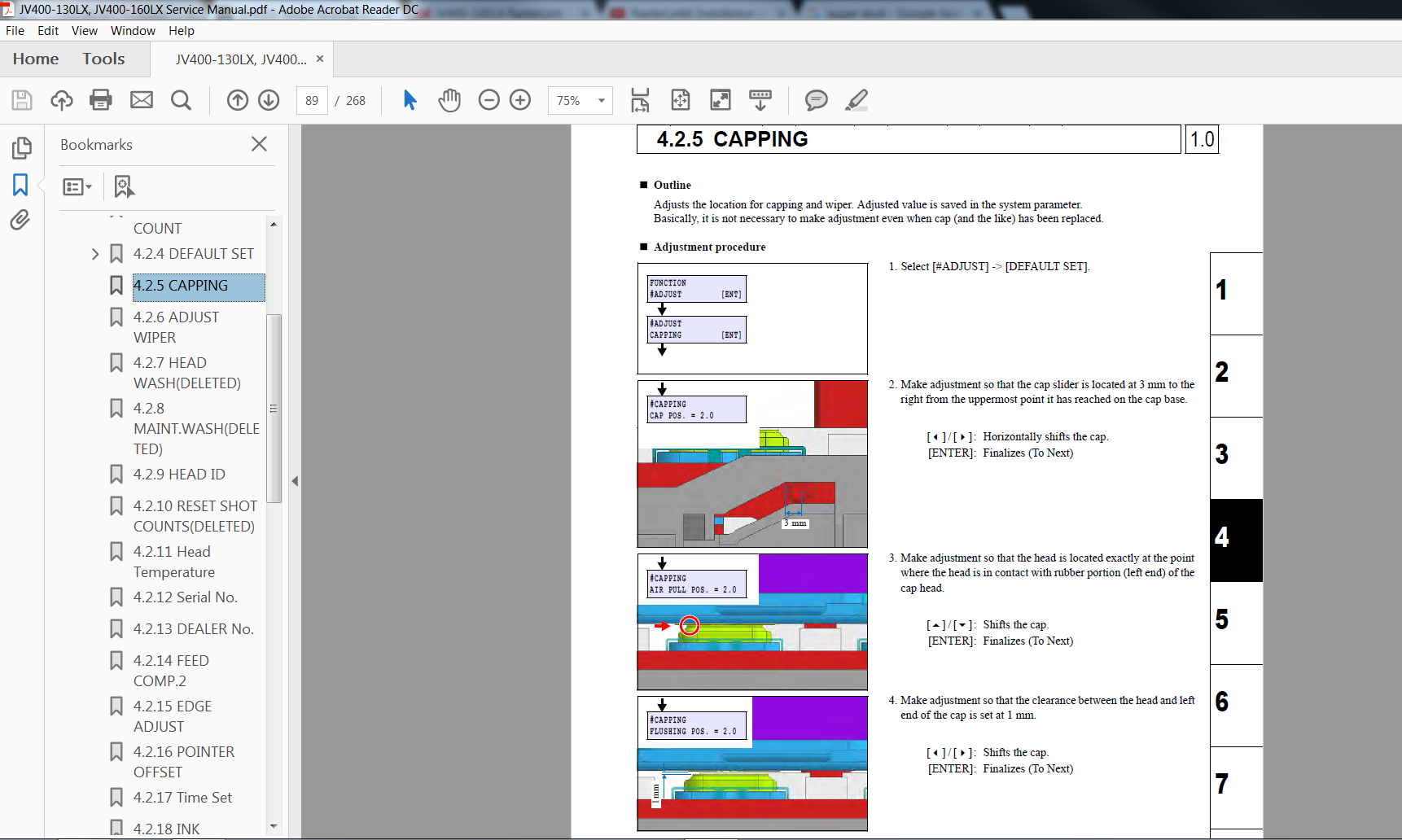

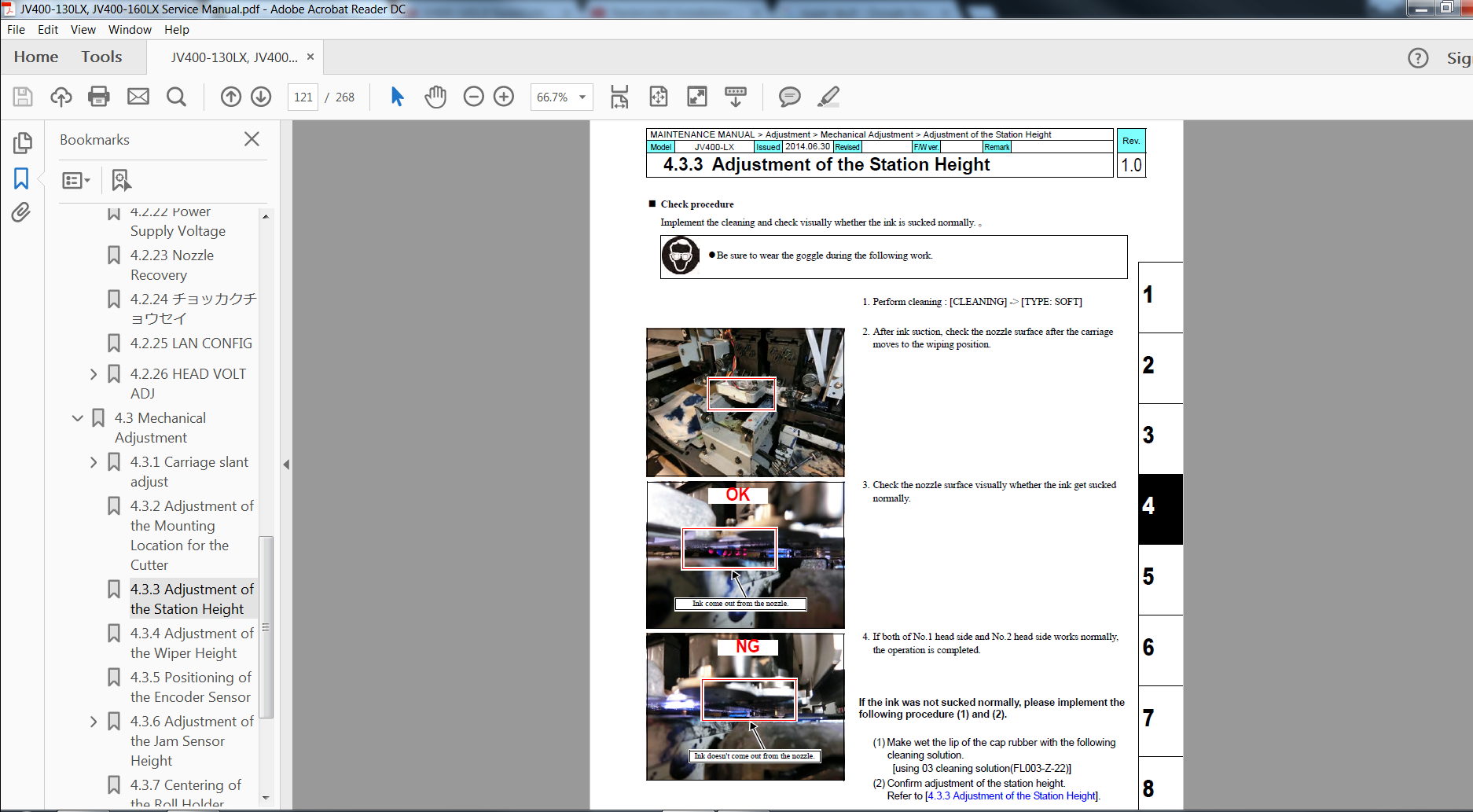

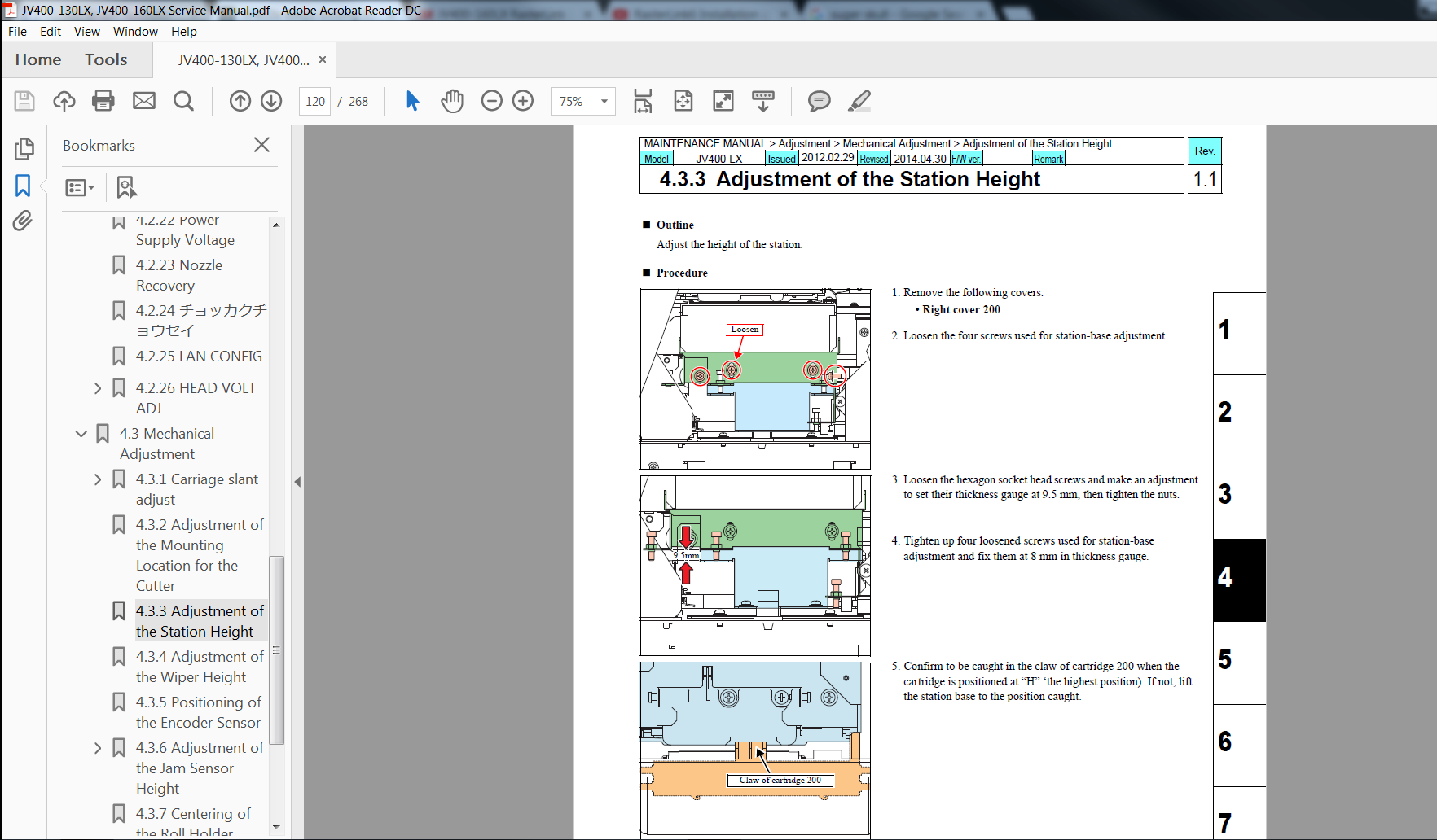

Came out this morning to find that the printer had lost ink again. But thankfully it was easy to diagnose. Anyone having trouble with damper leakage try these steps cause it worked for me.
I performed a damper maintenance to check that it fills and holds and I had an error 61a so doing this cleared that error (Thanks Pitzu).
Then did a soft clean and watched the damper ink levels.
If the levels start to drop then station height and capping adjustment may need to be made.
In my case something had moved and the capping pumps where sucking the ink because the head didn't have the 1mm clearance while in the flushing position.
(wondering if its because when I got the printer the head was only used on the high setting and now I only use it on the low setting?)
Hope this helps someone in the future.

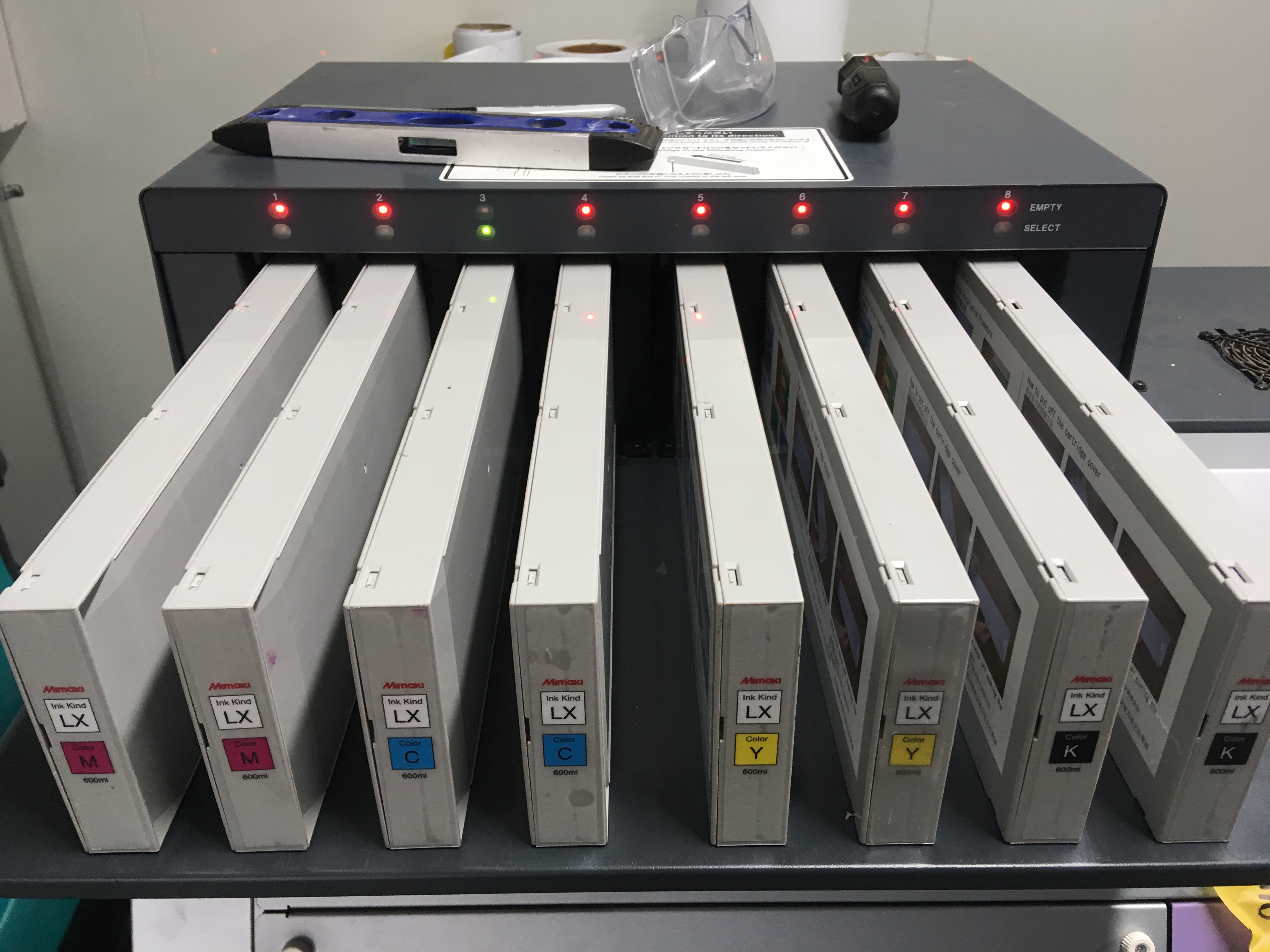

I'm losing pressure somewhere towards the head/cap. I've tried the cap adjustment as listed above.
When the machine (JV400LX) starts in the morning it thinks it has run out of ink and displays all red lights on the cartridges.
I usually have to do a few cleans or a damper fill up to clear this - with the associated machine restarts.
