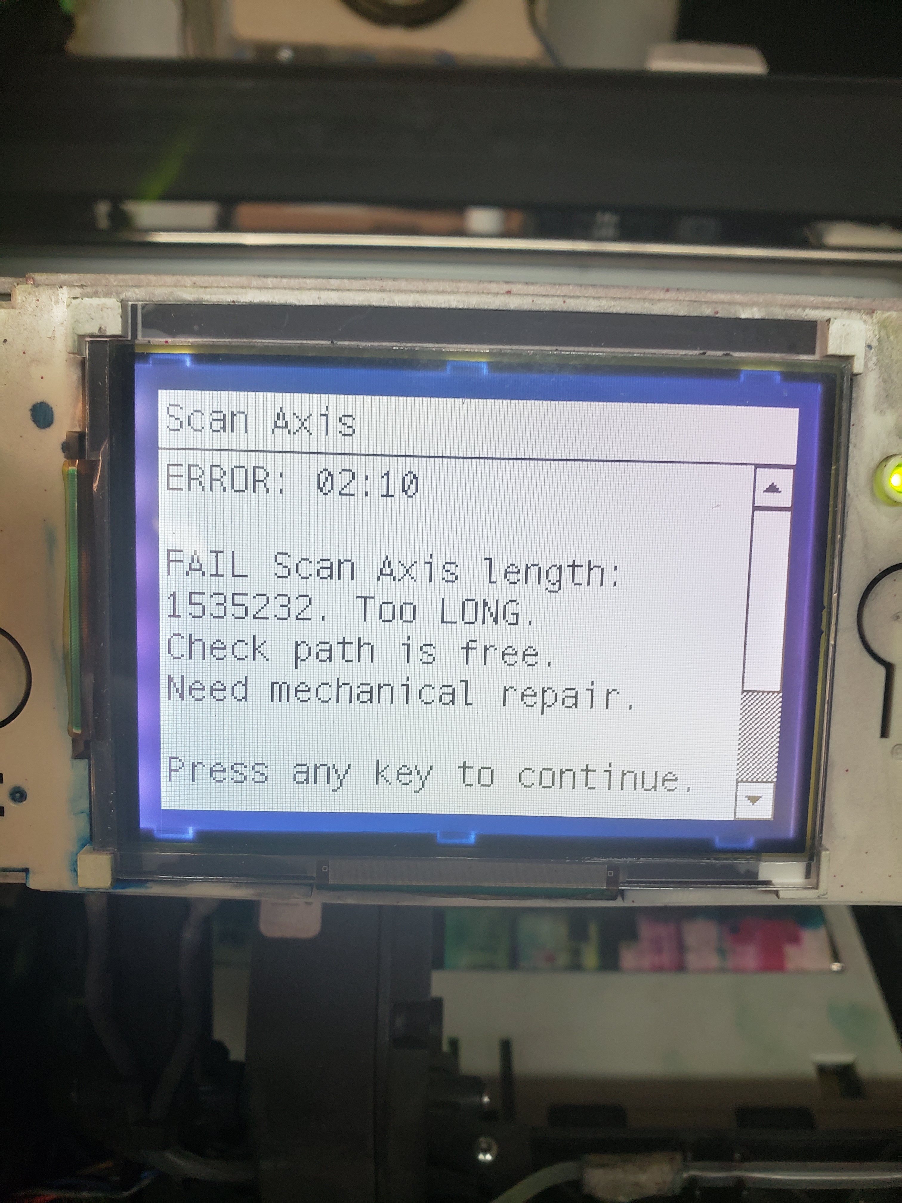

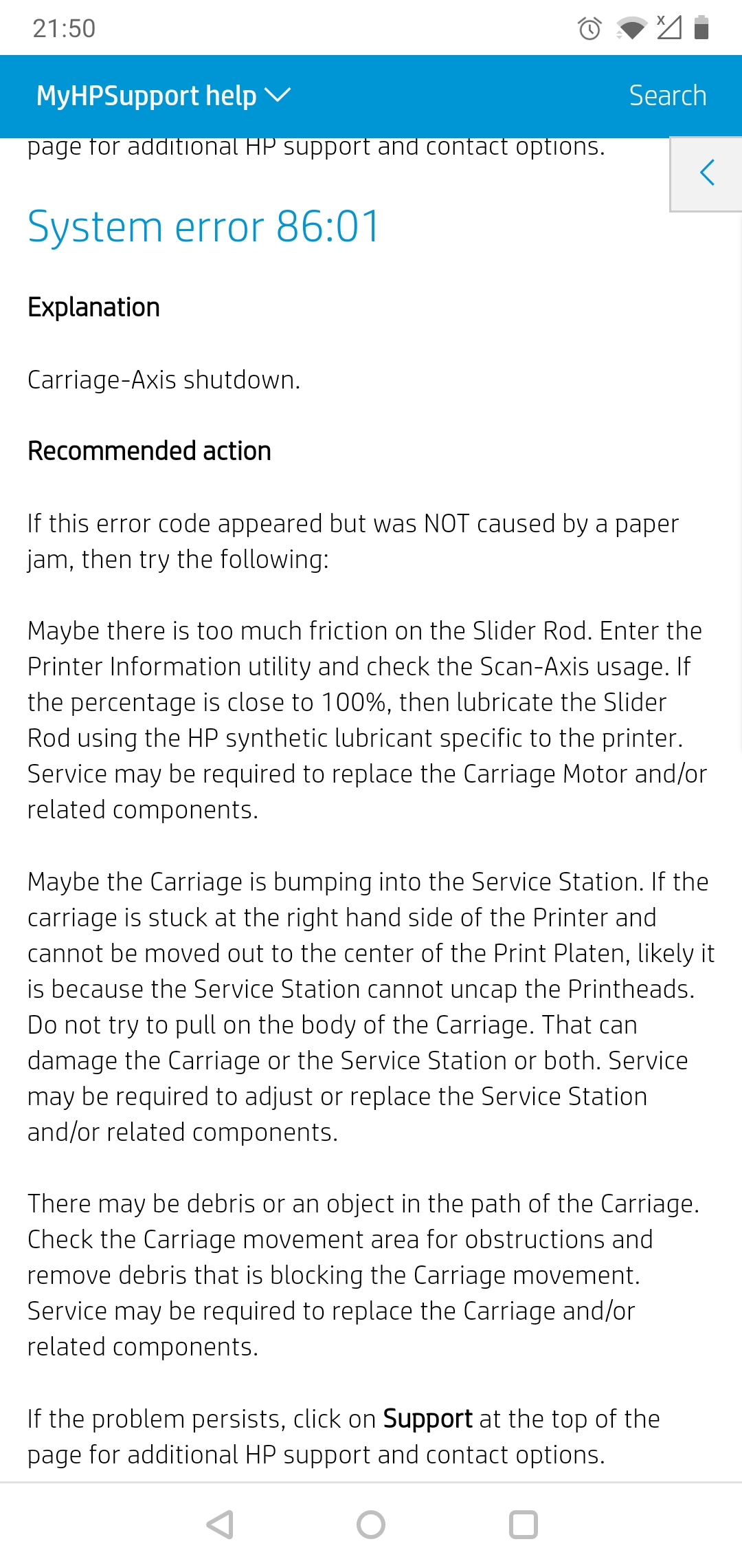

Ok I boot printer up it loading the cartridge move to right then when it goes to the lefted it gives me error 86:01. But when I do the scan axis test it give me this error.

Scan axis fail again

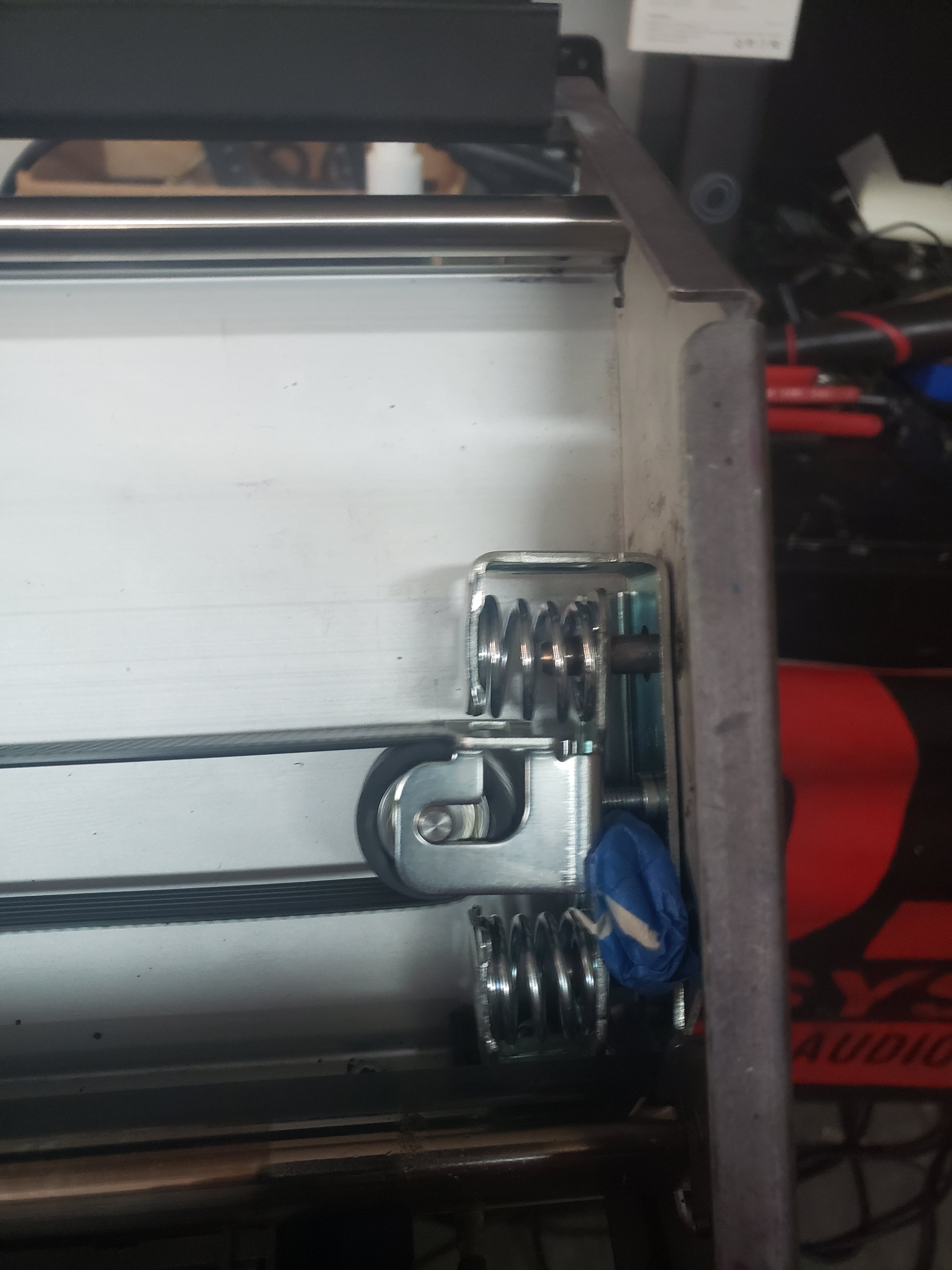

I going try keep adjusting the rubber parts to see it one pass first one fail still.

Use good rubber piece.Solid as in my photo.

ok i just notice when i do scan axis test it says its going to move cartridge to the middle but it dont it move just alittle from the left side
how do i re calibrate scan axis i am in the service menu but i dont see it at all
