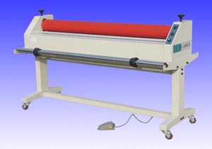

Another question...mine came only with the main red roller and the two roll holders with one common bracket. Looks like this new one has some kind of bar in front of the roller, another just behind and a little above, and the laminate roll holder up high and behind...is this the case or am I seeing things in the photo? I'm trying to envision what this "update" kit will look like to go on my machine, since there are no provisions on mine for these smaller-looking front/back rollers...are those powered at all or just along for the ride?

One Red roller? Mine came with two Big red Solid rubber rolls! One top one bottom and four take up and Film rolls

Here is they way mine came. The lower brackets on either end of the macine that hold the carrier paper and laminate roll are the ones I replaced.

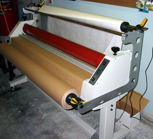

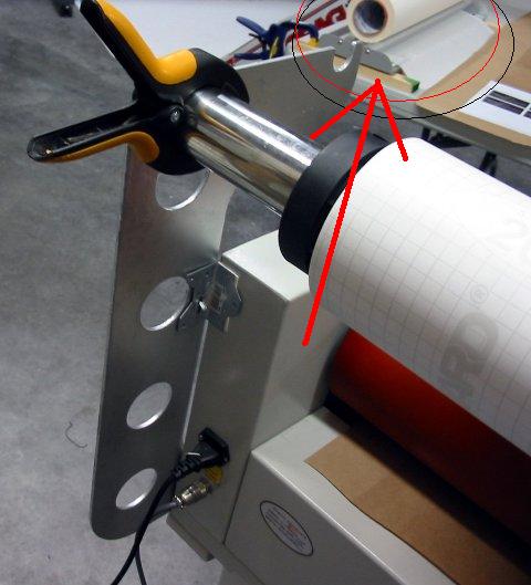

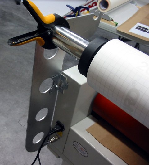

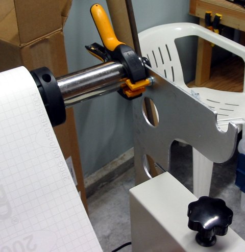

Here are the pix of the mods I made to mine. I just got an "update" kit, but I am not too impressed with how it came. First off, mine does not have the provisions to locate these new parts, and second, there are no directions, measurements or pictures of how to locate these things. Sure, I can guess, but that's all it would be. So, I've got PCSS looking into getting me that info. By the looks of it, I have in essence already accomplished what they've done, but mine is a bit cruder in application.
I designed the silver brackets and had a machine shop make them for me. Also, I now use a 3" core on the second rod there for a manual liner take up.

What kind of setup do you have on your application tape dispensor? Looks like you've modified it and made it stationary? I cant tell for sure by the pic... I have one but I find it useless. Care to share, maybe Ill drag mine out and get some use out of it finally.

Oooo, you are a sharp one, eh? I didn't even notice that in the pic. All I did was put a piece of 1"x2". For the fastener thru, I removed the fastener that attaches the 4 feet underside and used a wood screw thru the aluminum base, the feet and then into the 1x2. This moves the base up a bit to make it more usable, and then gives a place to clamp to onto the table.
I made my own at first, but I like this one a lot now with this simple mod, and use it all the time now.
