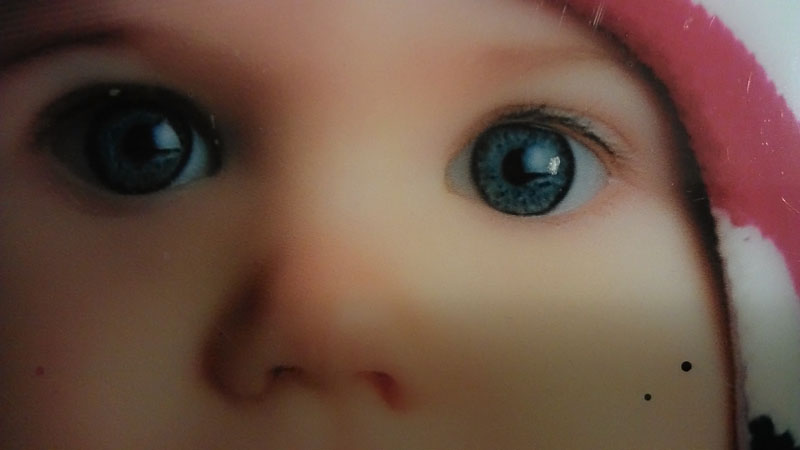

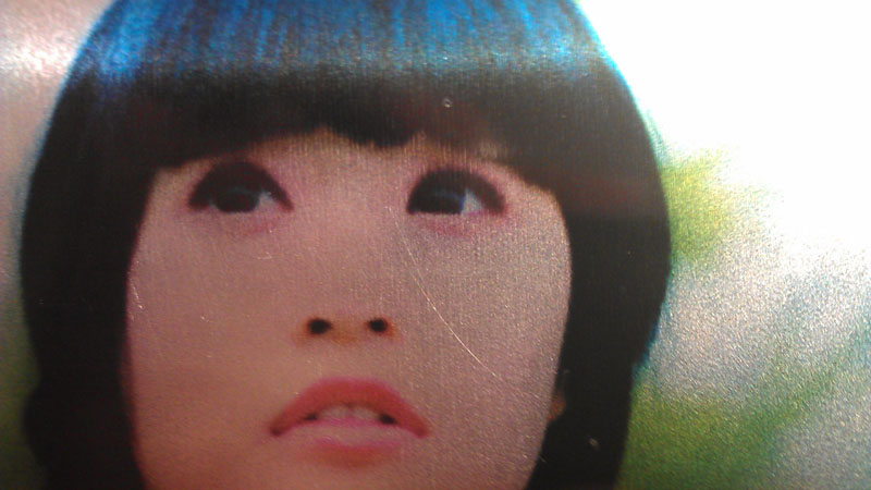

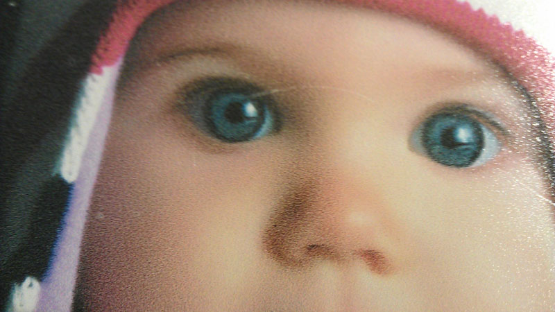

some pics. prints look better in reality, i'm not an expert photo and pics are taken with my phone.
low rez print on PVC board, hi rez print on white plexi, normal print on aluminium.
