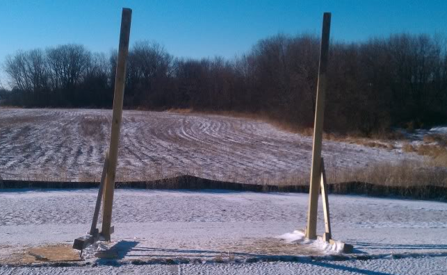

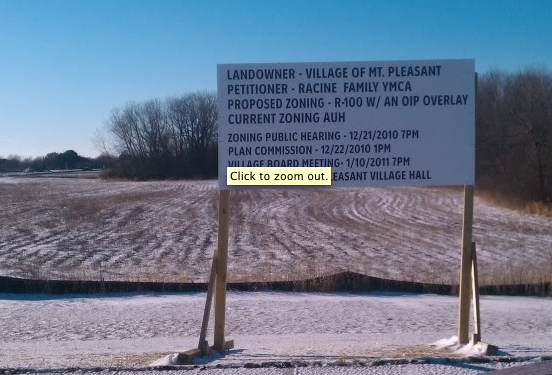

sure! i actually posted a drawing somewhere in an old thread (i'll add to this thread when i can find it) but here's pix to give you an idea:
Screen shot 2011-02-24 at 1.06.52 PM.png Screen shot 2011-02-24 at 1.07.02 PM.png
i devised these so that I can install myself, without any extra hands. My first one held up for an entire year before I had to remove it... I still have 2 more I've installed recently that just weathered the HUGE storm that just hit our area:
The T-frame at the base is held together by a thru-bolt, which is kept loose until i hammer 2- 4' Rebar through each leg (front/back) at a slight angle. I then raise each vertical post to level and tighten the bolt, and secure with 2x4's so that each leg is able to stand up on its own. Temporarily screw a 6" block of 2x4, level with each other, to each post to utilize as a "ledge" to help hold your MDO level/square while securing with screws to the posts. Remove blocks, and give the Rebar a few more knocks to make sure the sign is firmly in place.

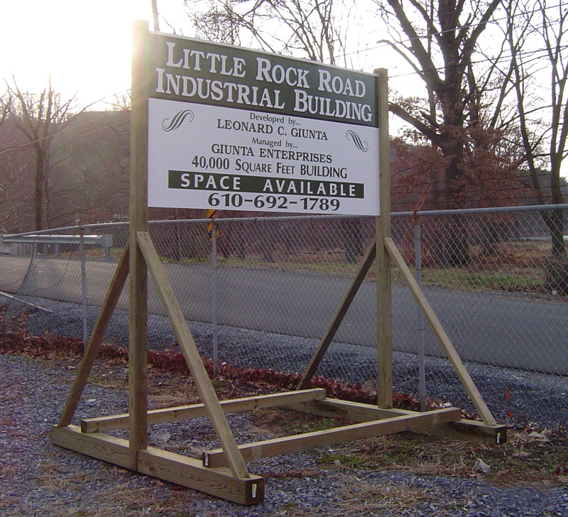

Here's one we did and I still have a picture of it.
This frame was made in-house and then the sign was installed on site along with the cross runners and then we spiked it. This is using 6" x 6" for the base and the rest is 4" x 4" and 2" x 4" lagged together. This has been up for over three years now. Because of the height, we had to go a little beefier down below. Normally, we use 4" x 4" for almost everything.
This is a very good way to install this stuff, if you're on macadam, cement or any non-digging surface.
Been using these for over 35 years and never had one to date blow over. :thumb:
