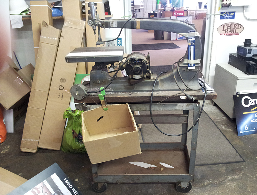

Here's what we've been using, since I can remember.
