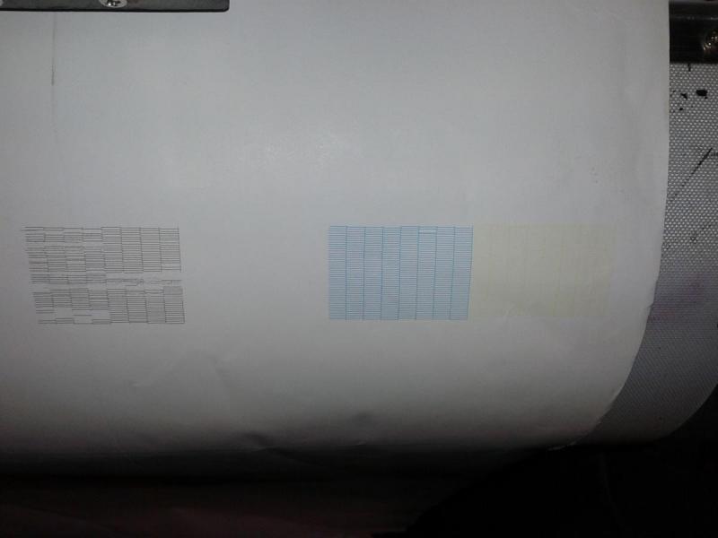

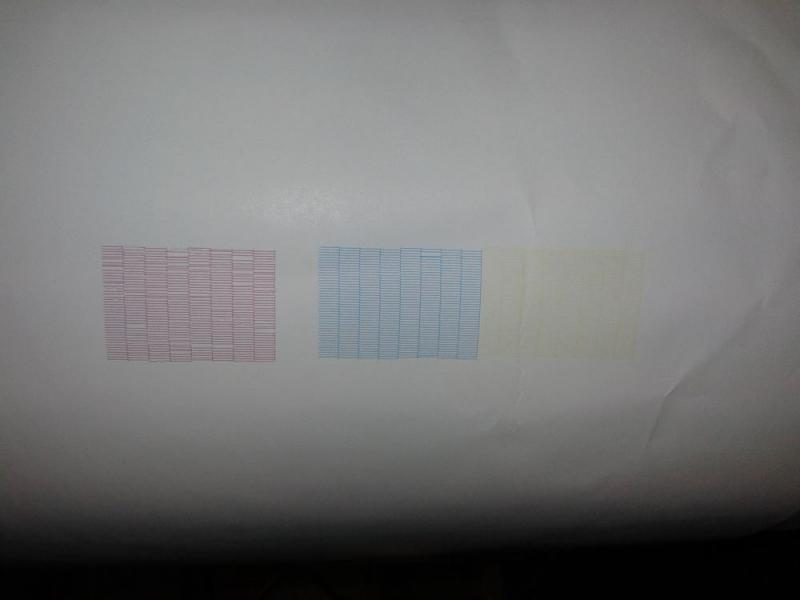

I had the same error 07. I replaced the print head and error is gone but cant print. Any ideas?
test print - pic1
swat data test print - pic2
All data cable is new.
Best regards
Mario

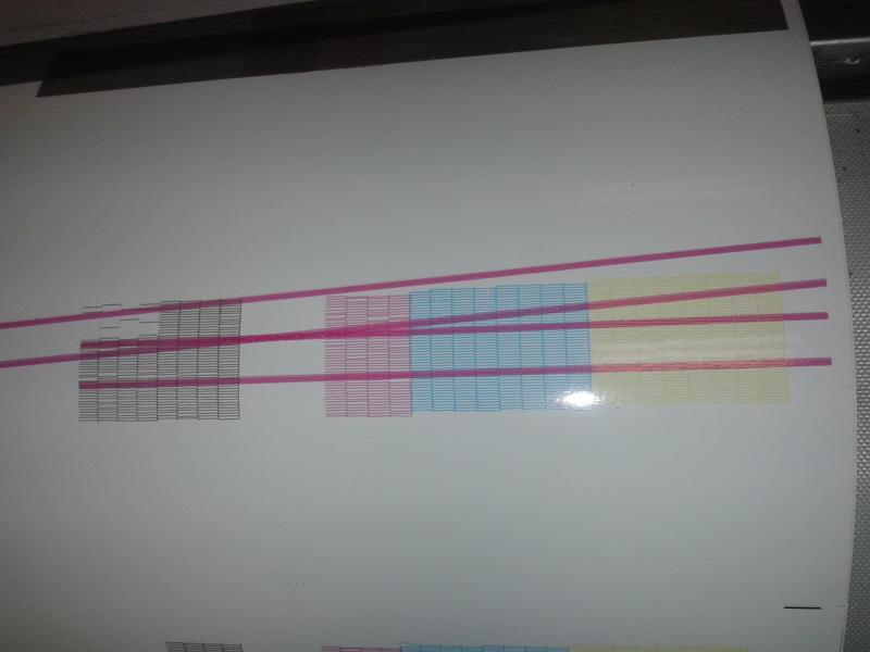

Hi,
The Slider board is fixed. I think so. Test print looks like --> fix1.jpg . Just half head prints. Do you have any ideas? Thank you for your suggestions.
Best regards
Mario
