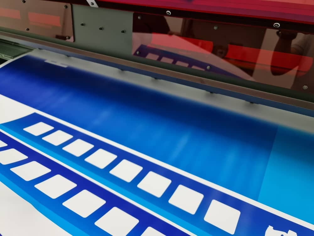

Hi, hoping someone can help
I have a Mimaki UCJV 300-160 and am now seeing patchy prints, especially noticeable on block colours, mainly darker blues (always the worst flat colour). I have had the Air Purge error come up quite often so have gone through the process but it still reappears. The machine is out of warranty now so any advice would be helpful, it happens on all medias, see photo.

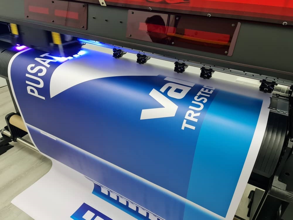

Hi all, i started to have the patchy print too and it's getting obvious when using 600 x 600 16 pass.
It's strange that 300 x 900 12 pass is better then 600 x 600 16 pass.
Just bought the printer on Jan 2022 and already informed the technician regarding this and till now they didn't have any solution for this yet.

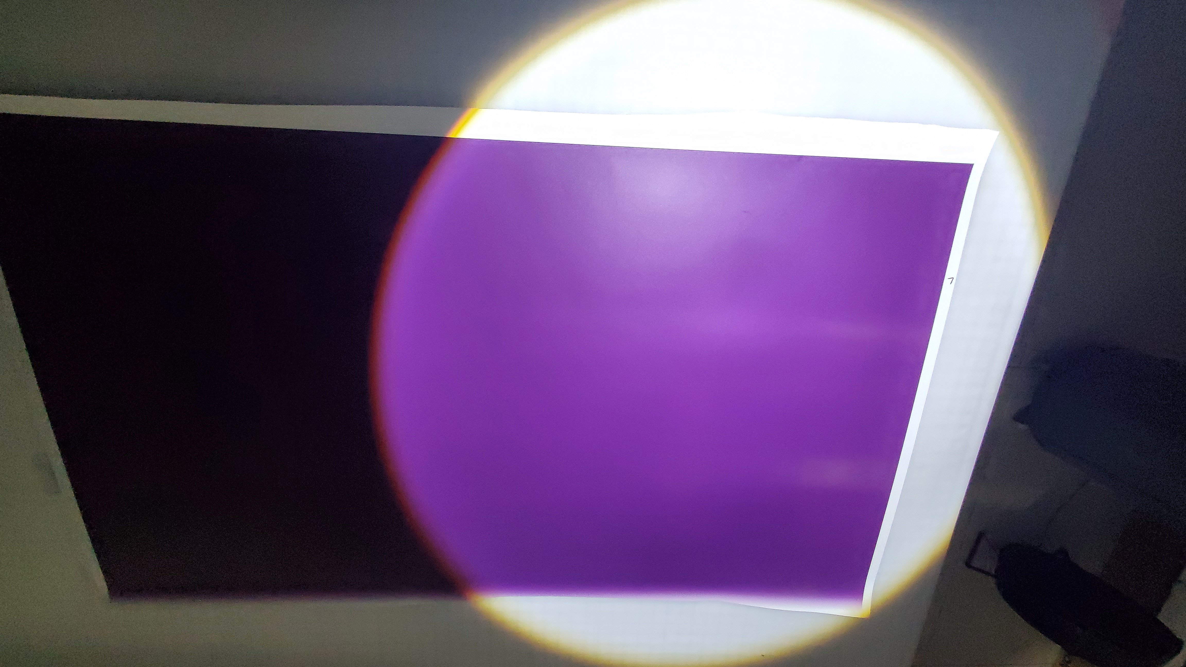

Glad I found this as I have the same issue's with my UCJV300-160. Solid colours print with blemishes, tone jumps (whatever you want to call them) and then issue with the film slightly lifting between pinch rollers and the vacuum then getting these weird darker tone marks. Not sure what the fix is. uni direction? higher res? nozzle test is 100% fine.
What did you guys do to fix??
Regards
TheCPC
I think its a vacuum and pinch roller issue. The machine needs more pinch rollers because its creating lifted areas where there is no pinch roller (hope that makes sense). On my machine I get heaps of patchy printing in dark solid colours, assuming everyone else notices that too. I almost cringe when I need to print them the only thing I can think to do is over laminting with matte laminate which hides some imperfections. Does anyone know if more pinch rollers can be added or is there a way to add a better vacuum?
TheCPC
I have this issue too. Visible in dark color blocks. Sometimes just bands like on your photo's, other times sort of weird patterns. Don't know how to describe it other than that. Might have to do with the lifting/bulging of the media i have a lot of the time. Also have minor headstrikes/ink wipes a lot due to the slight lifting of the vinyl. Attached photos show the patchy printed areas in the black section. Supposed to be 100% black, no gradients or jpg artifacts what so ever.

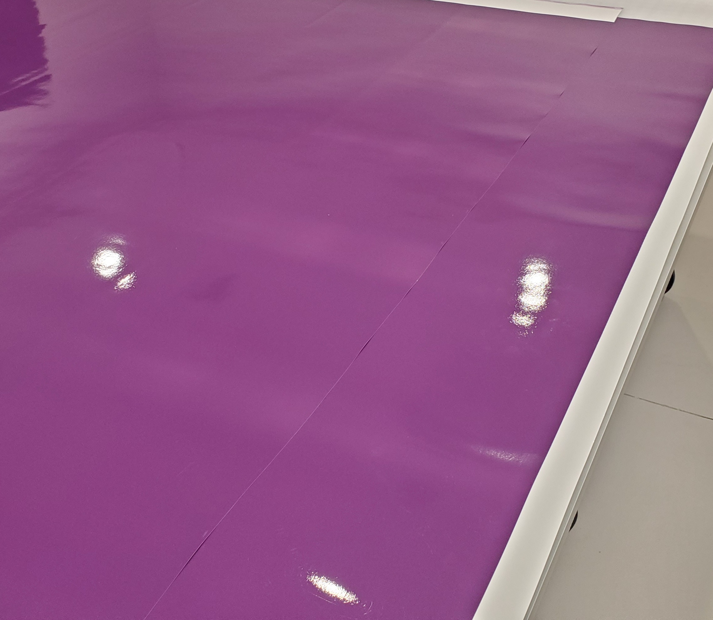

Has anyone found this actual cause and solution for this issue? UCJV300-160 going on 2yrs old, now it doesn't want to print solid color without fade bands. Updated firmware, adjusted feed comp, adjusted droplets, air purge, vacuum set to strong. Did I miss anything? Humidity controlled print room 45-50%
