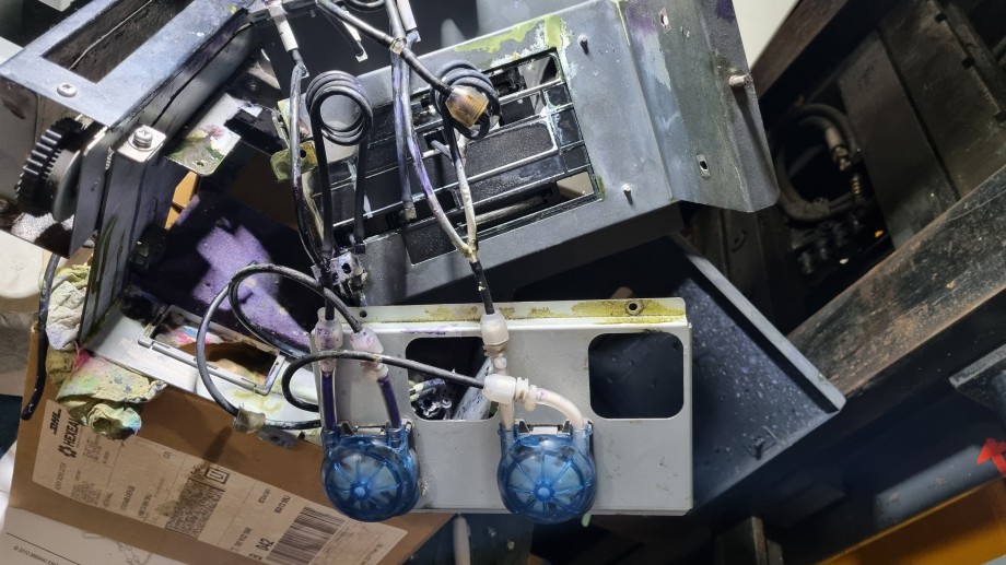

Getting the pump head plate assembly out wasn't particularly easy, the capping section had to be unscrewed to make it easier (had to come apart anyway for cleaning)

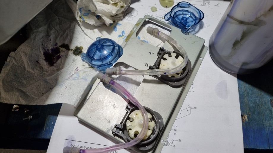

Separated the pump heads, and flushed through the peristaltic tube sections with ethyl acetate just to clean up a bit so don't get ink everywhere when removing the barbed connectors to replace the tubing!

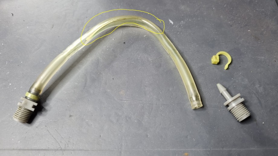

The piece of tubing laying loose at the bottom and extricated earlier for measurement of replacement hose (Platinum Cured Silicone, 3.2mm ID, 6.4mm OD was ordered) has a nice split in it:

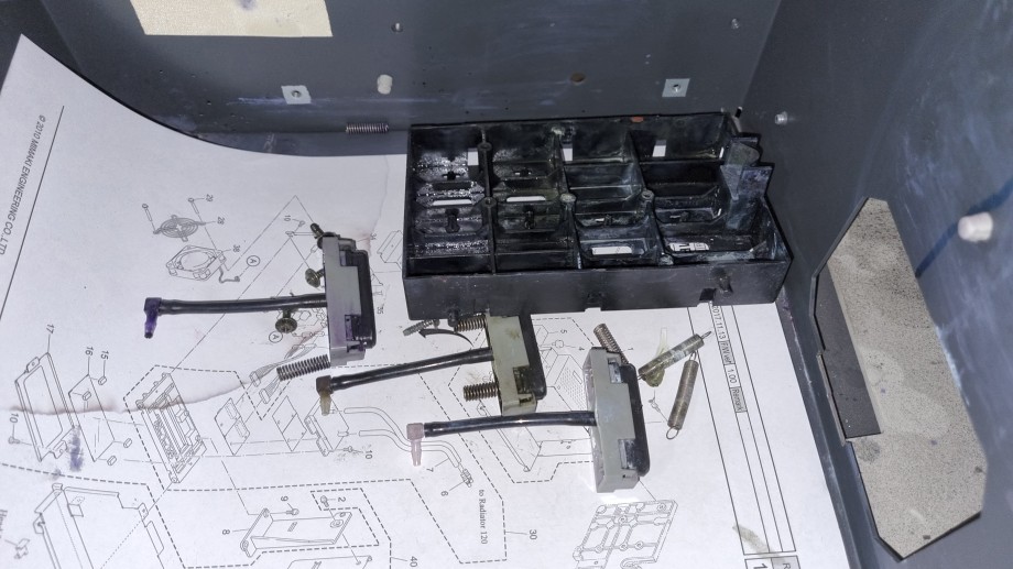

The caps (cleaned a little) and capping assembly separated for attempted repair of the top plastic plate... They appear to be in pretty good shape. will clean the springs and apply a little grease on reassembly.

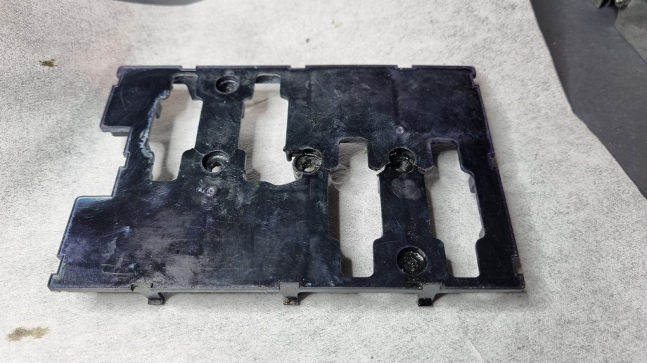

The top plate that's split in several places, going to attempt gluing it first (after decontamination!), as it's not difficult to get out again if a more durable repair is needed.
I wonder if the plastic here has been weakened/attacked/made brittle by cleaning solvents or possibly ink itself along with the spring pressure (interestingly the dark grey paint coating on the printer inside panels peels off a bit in places too where ink has sat presumably for years).
