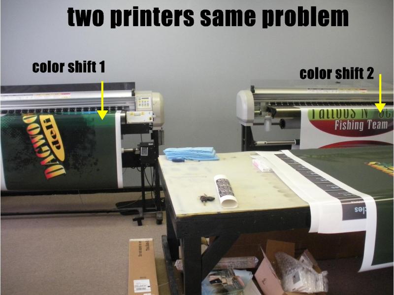

We have new complete maintenance stations from mutoh...the dampers are all holding inks...the techs seem to think its air from the cartridge but said they couldnt say too much..both machines are doing it..and they are different year models..thats why i blame it on the ink..I have replaced everything mutoh claimed to be the problem. and I cant get any answers from them..all I know is Im wasting a ton of money and materials dealing with this..here is a picture below

I assume from the picture that it starts printing the correct color and nozzles drop out. Is this correct?
Plugging dampers will hold ink, but may not feed it to the head fast enough, and might explaine what you are seeing.
This would point more to dampers, IMHO.
When was the last time dampers were replaced?

I just think it's a little strange that I have two printers one is 2 years older than the other and they both started doing the same thing at the same time...which happened to be when the new inks came out in april...I heard that mutoh is testing out these cheaper inks on falcon users before they release them to other machines....I think its pretty crappy what they are doing its takes me twice as long to print a job now and uses twice as much material...the techs said they couldnt say anything for legal reasons..it had nothing to do with not knowing the problem..they checked all the dampers and said they were fine.

Just a thought but as you have replaced the stations already why not replace the dampers, afterall they cost very little in fact probably less than the cost of the material you have wasted in the photo. A word of warning be careful with them, a delicate touch is needed, but I think it is your problem, when dampers give problems it always seems to be after cartridge changes. Oh and I don't work for mutoh

The typical way to test dampers is to do some long print jobs and see if nozzles drop out during printing (ink starvation in the head). Nozzles drop outs and no bubbles in the ink line are typical of damper issues or leaks between the incoming line (o-ring/tubing/nut) and the damper or the damper and the head (broken nipple).

Why don't you replace the dampers in only one machine and see if the problem goes away, if it doesn't, then that rules out the dampers as the source of the problem.
I truly think if it was the new ink, the problem would be constant and not just in some areas of the print.

ghost you are right..and I dont mind replacing dampers but I have spoken to at least 4 people with the same machines and they are doing the same thing...and they have replaced the dampers that's why I havent gone that route yet...but I will if I have to..I think the starvation of the heads are coming from the cartridges not seating well in the machine ...I just wish mutoh would handle the situation a little better... someone told me they ran tape across the back of the cartridges to hold them in tighter..I tried it and my machine has ran fine since, but its ridiculous to have to tape them in every time. Also the techs from calgraph said they have had to put 1 inch strips of PVC in the bottom of the cartridge holder so that the cartridge seals well into the machine...and when they tell me they have done 6 machines in one week that lets you know somethings going on....and thats why I havent ran to replace the dampers yet. Im just not convinced that they are the problem

I folded some currogated plastic and wedged a piece under each of my cartridges, noticed a nice change for the better in my nozzle check. :)
