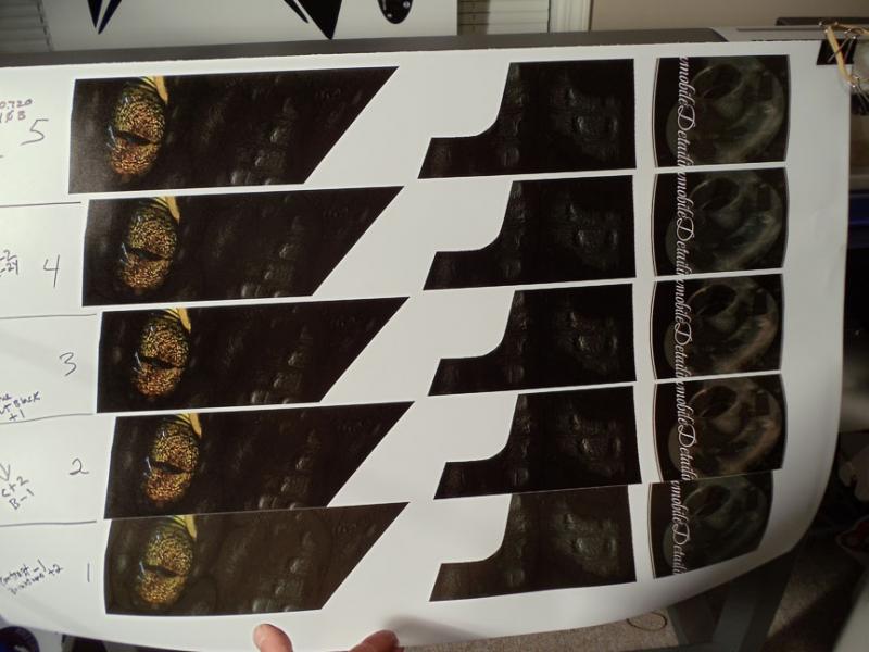

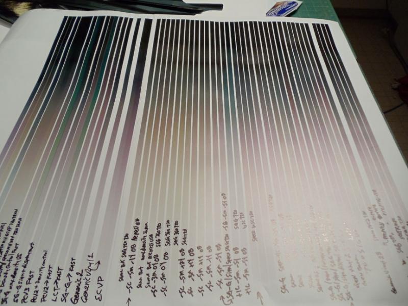

Well I have tried, a lot of changes, gasp.................
I have attached a couple sample sets of a black & white gradient.:omg2:
Tried a variety of setting, profiles, tweaks, 52 times to get something that will be acceptable. I see now that just about each file that has a B&W theme to it will have to be calibrated, otherwise, full colour printing is just fine.
I did end up injecting ink into an empty cartridge.
Thanks for the help:thankyou:
