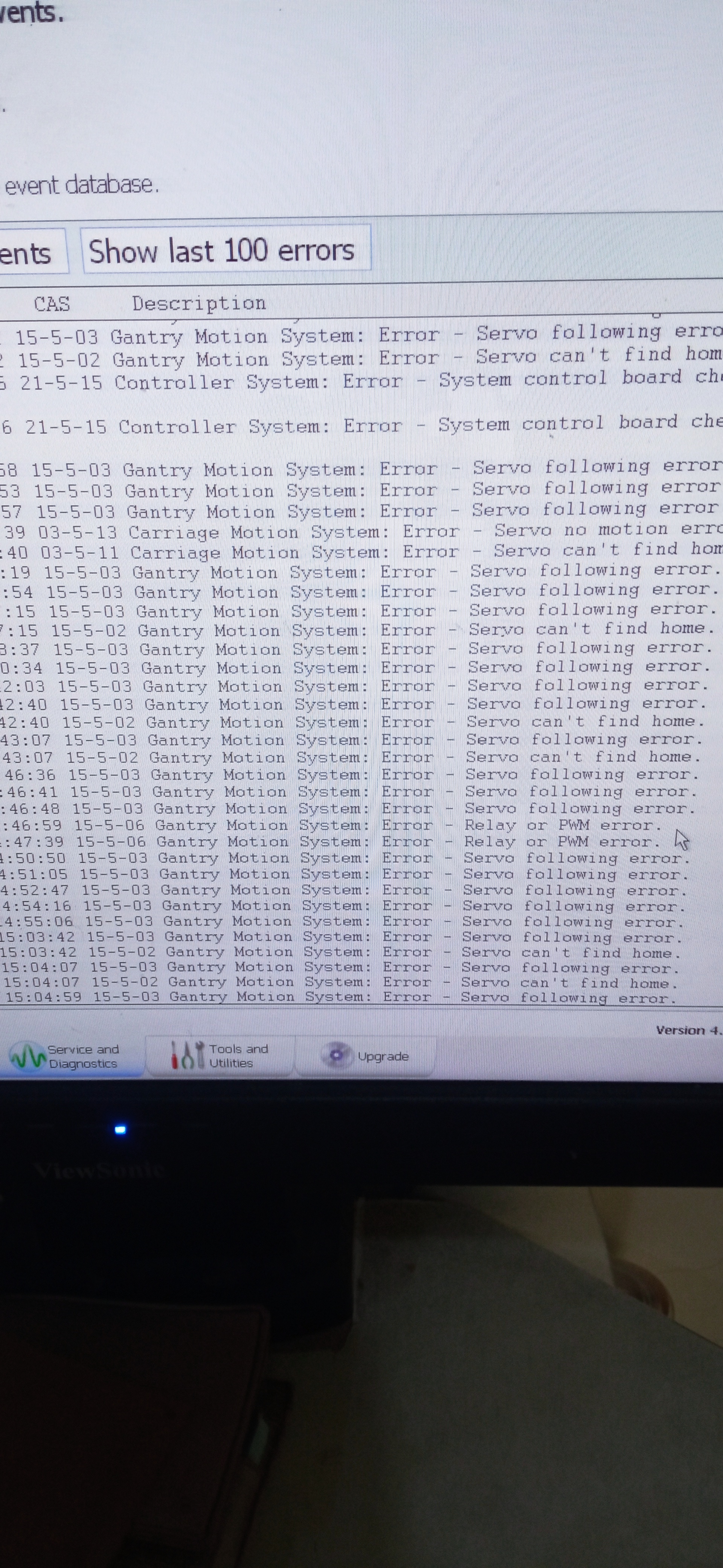

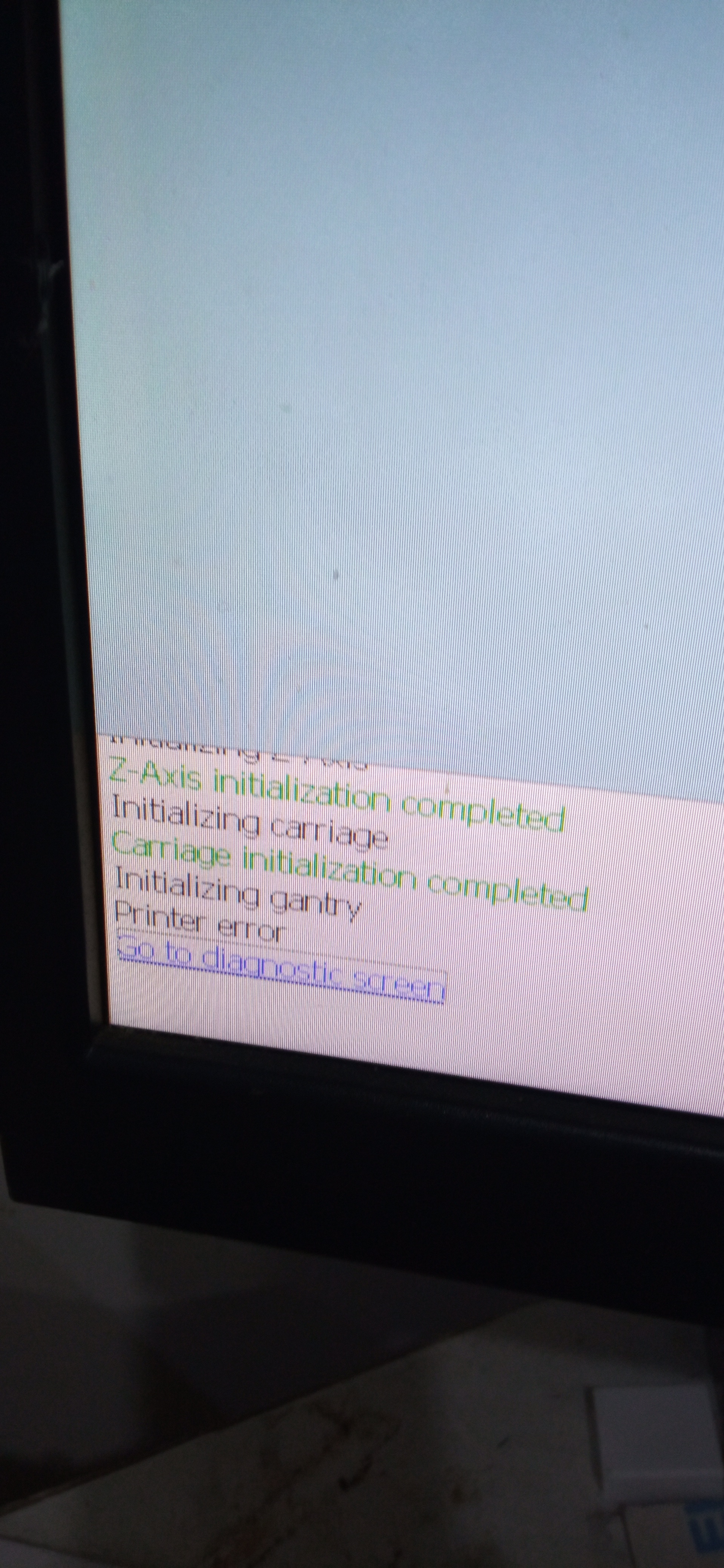

Yes the initialization is correct, only when after i engage the carriage guard then it says printer error. No the gantry does not move. On sds in last errors, it says gantry motion system error, servo following error, servo cant find home.
During the initialization printer moves the gantry a little bit. Is this movement visible? Can you move the gantry using the command from the SDS menu? If you switch off the printer completely, then move the gantry somewhere from the home position, will it return to the home during the initialization?
No it would not move at all when i do any of those things

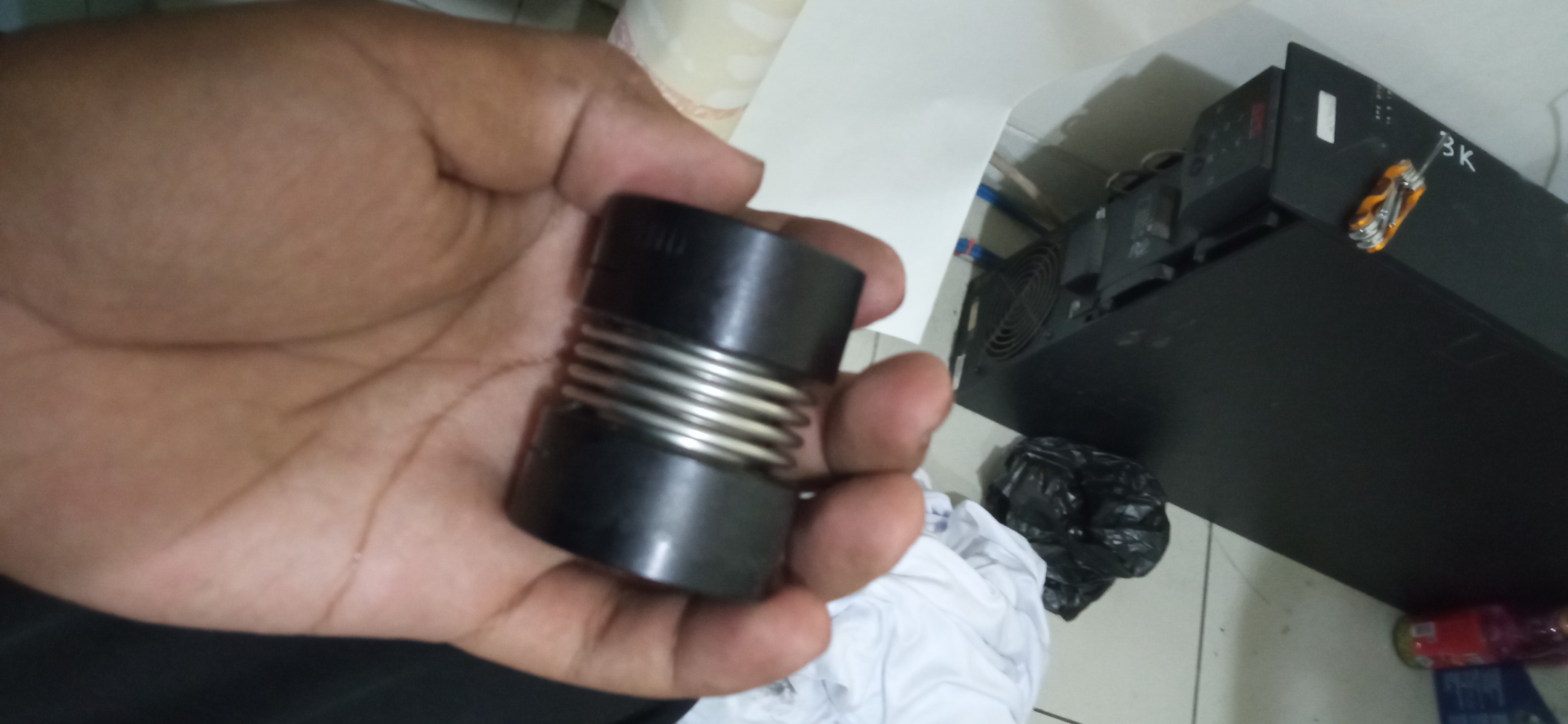

Seems that your printer can't move the gantry. Without deeper diagnostics, it's challenging to say why. It may be a problem with the motor, belt, coupling, or electronics.
