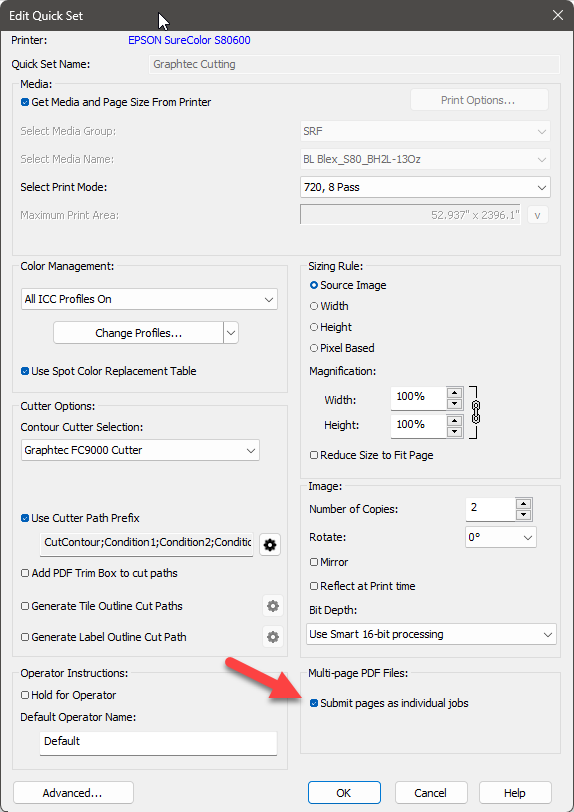

ONYXtechtips any plans to fix this? I feel like this is a pretty substantial bug that could cost your customers a lot of money, while paying a lot of money for this "upgrade".

Of those who have experienced this problem, please provide me with some details and I will chase it down. I would need to know things like the printer used, cutter used, what the file prep was (multipage PDF created in Illustrator or some other method), version number of your Thrive, did you use a custom quickset, if so what were the cut settings, did you process pages as individual files or as one. I do have a meeting this morning that I can address this issue and get a resolution at least started. We would need to be able to replicate the problem to be able to identify what needs to be fixed if it is broken. Please send me a private message if you wish to keep your details private and I will do my best to address it.

I can tell you it happens on any printer with multiple pages, both pdf pages or artificial pages created by onyx. On the Colorado it crashes the RIP when sending more than one page to the printer. On the HP R2000 it sends corrupted print data to the Print IPS.

Over the last hour I tried to replicate the issue you have described and I think I may have found what is incorrect. I know i can hear the groans already, but it has to do with how your quickset is set up. Since each page has a different cut path assigned to it, you need to regard each page as an individual job. In the quickset settings, under the Multi-page PDF File settings, click on "Submit pages as individual jobs" to enable. Then each page will be brought into RIP Queue with its own independent cut path assigned to the file. If individual jobs is not selected, you are telling RIP Queue that the pages are all the same and only one cut path page is required.
I will discuss with my team about making improvements to this area for better understanding, but it is not a bug. It is however a job handling issue that needs to be better understood. Each page is different - the print settings maybe the same but the cut information is not, therefore, it must be handled as independent pages.
