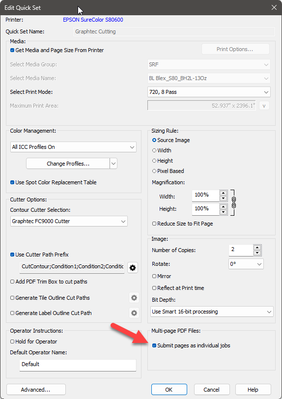

I'm going to try this later. I had this issue escalated to engineering when I called about 3 weeks ago on this and haven't heard anything back on it.Over the last hour I tried to replicate the issue you have described and I think I may have found what is incorrect. I know i can hear the groans already, but it has to do with how your quickset is set up. Since each page has a different cut path assigned to it, you need to regard each page as an individual job. In the quickset settings, under the Multi-page PDF File settings, click on "Submit pages as individual jobs" to enable. Then each page will be brought into RIP Queue with its own independent cut path assigned to the file. If individual jobs is not selected, you are telling RIP Queue that the pages are all the same and only one cut path page is required.
I will discuss with my team about making improvements to this area for better understanding, but it is not a bug. It is however a job handling issue that needs to be better understood. Each page is different - the print settings maybe the same but the cut information is not, therefore, it must be handled as independent pages.

Well, can you get them to fix that? currently, when I have parking meter decals, each decal is it's own artboard (page in a pdf). I don't want to send them separately because there are upwards of 100 pages in each PDF. I don't want 100-300 different jobs in my rip queue. It works great now - but the upgrade would be a downgrade in this respect.Over the last hour I tried to replicate the issue you have described and I think I may have found what is incorrect. I know i can hear the groans already, but it has to do with how your quickset is set up. Since each page has a different cut path assigned to it, you need to regard each page as an individual job. In the quickset settings, under the Multi-page PDF File settings, click on "Submit pages as individual jobs" to enable. Then each page will be brought into RIP Queue with its own independent cut path assigned to the file. If individual jobs is not selected, you are telling RIP Queue that the pages are all the same and only one cut path page is required.
So you have a file that is 100s of pages, independent, different image, all printed the same and cut the same. The only thing different would be a number or color. If so, you are good to go without individual pages. Your situation would have the print is the same settings and your cut is the same settings so my scenario still applies. If each page is a different cut path, then the pages would need to be independent. In fact your situation would be a huge problem since each independent page would have its own bar code and registration - so that would not work. You can continue to use it as you have, as it is the preferred method for your situation.Well, can you get them to fix that? currently, when I have parking meter decals, each decal is it's own artboard (page in a pdf). I don't want to send them separately because there are upwards of 100 pages in each PDF. I don't want 100-300 different jobs in my rip queue. It works great now - but the upgrade would be a downgrade in this respect.

This is not the issue I have, my issue is if I need to print say 500 copies of something and set my page length to say 96", onyx will nest the files and it should generate a cut file that it send to cut server for each 96" page, however onyx is not generating a unique summa barcode for each page, all the sheets will have the same barcode, even if the cut paths are not the same.Over the last hour I tried to replicate the issue you have described and I think I may have found what is incorrect. I know i can hear the groans already, but it has to do with how your quickset is set up. Since each page has a different cut path assigned to it, you need to regard each page as an individual job. In the quickset settings, under the Multi-page PDF File settings, click on "Submit pages as individual jobs" to enable. Then each page will be brought into RIP Queue with its own independent cut path assigned to the file. If individual jobs is not selected, you are telling RIP Queue that the pages are all the same and only one cut path page is required.
