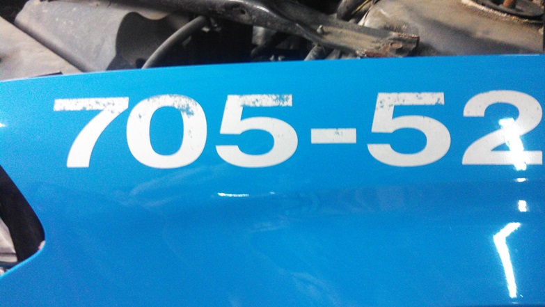

    Just out of shear curiosity and playing devils advocate for a moment... is it on more than one car and more than one location on the vehicle? I ask... because if it was one car, and on the fender location (only at the top as pictured), would it possible that someone possibly doing some mechanics work under the hood spilled some sort of chemicals on it that would cause it degrade?

    I wish...that would be an easy way to explain it. But no...the worn decals are on either side and the rear of multiple vehicles in different locations. Basically wherever they fit on each vehicle.

    Okay, thanks for the picture.
    That's almost just like a problem we're having with the 5600 reflective with no printing on it also and it's only been a year or two. However, ours are even discoloring and we don't use the wet method at all. I forgot all about this ordeal, until your picture. I'm gonna get back into it again.

    WOW- seeing that photo, it doesn't look like power washing at all, more like PRODUCT FAILURE!

    Ok, maybe not a mechanic spill, but how about the covers they put over the fenders to lean on? Maybe worn out and is wearing on the vinyl? (shot in the dark?)

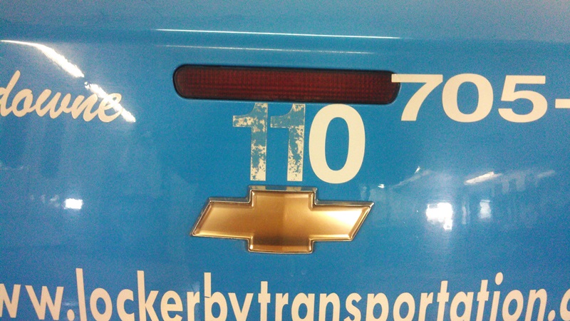

    In the picture it looks like I can actually see the blue of the car through the areas of damage. That's too weird. I have had issues years ago with a brand of reflective that had what looked like mould getting in through the top layer of clear and the colour. I believe that may have been caused by the acid used in no touch car washes, but never really got an explanation

    Here's another photo. It's of the trunk area. The "11" is the issue. The "0" is a newer decal because it had peeled off from dirt under the vinyl - that's why it doesn't look like the "1's". The rest of them are newer as well because he had recently replaced them after they lost so much of their reflective properties.
