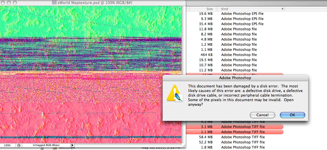

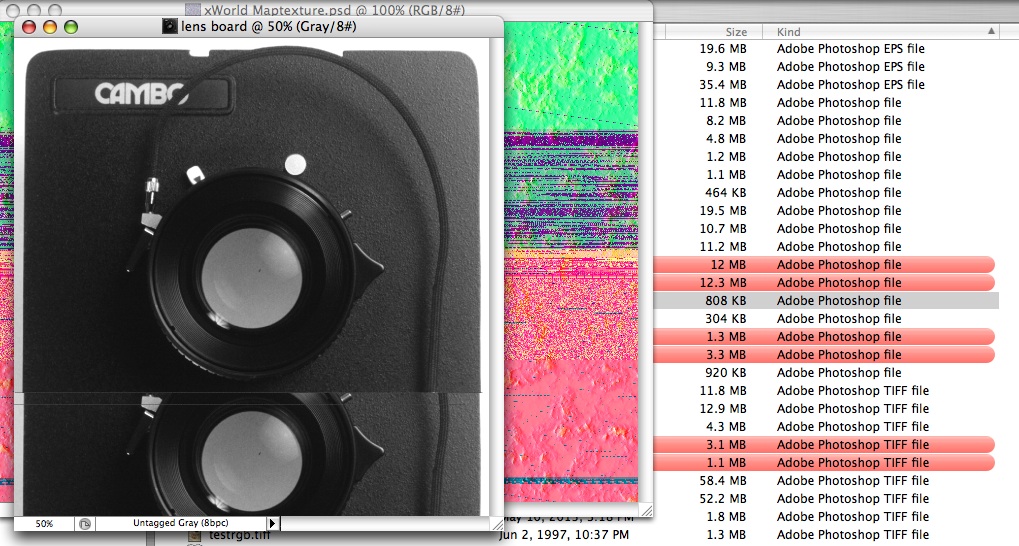

PSD can, and sometimes, will open damaged PSD files. See the attached images...
1) grabPSDerror1.jpg opened without error dialog and the entire image is faulty.
2) grabPSDerror2.jpg opened with error dialog (showing in example 1) and the bottom part of the image is faulty.
I see not only are these from creative suite 2, you get a warning dialog. Truncated tifs just open.
PSD is the best current pixel based file format.
