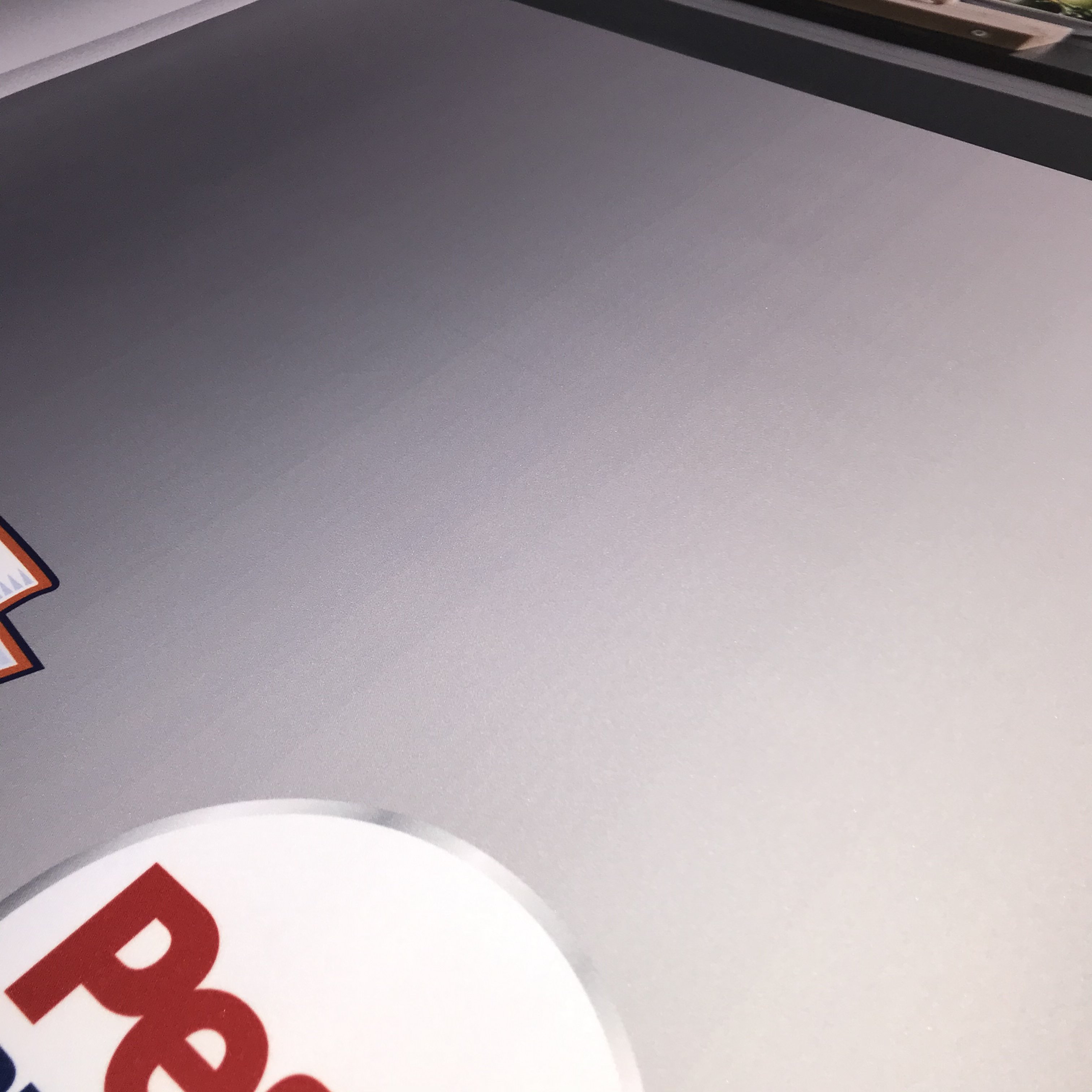

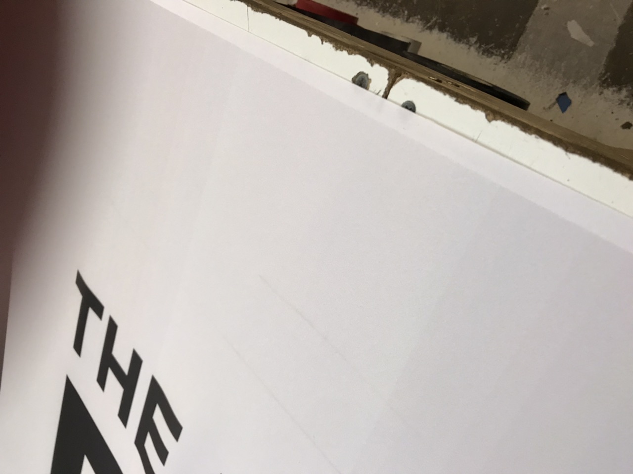

Andy_warp
This is why I don’t trust any compression. I requested native art and was denied. A bunch of vector generated gradients got flattened, compressed and embedded in Illustrator. It’s backlit, so all of these nasty bands will show worse. Especially the hard step to white.

These bands are not indicative of LZW compression issues.
