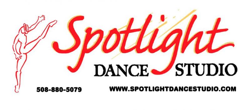

I rolled on the Gloss Enamel paint last night on the signs and I'm going down today to see if it needs another coat, it went on thin. Then I'll do the lettering and such. This is the sign they want below.

OldPaint
NOW WE HAVE AN IDEA of what the ****** your tryin to do THANK YOU))))
like i said about the sign being 40 ft up......it will read like a 2" x 3" busness card at full arms lenght!!!! KEEP THIS IN MIND...while you read below.
#1 yellow highlight/shadow DONT DO IT.......just makes it harder to read.
#2 think about increasing the thickness of the TEXT & the graphic,
#3 you may as well not even pt the phone number and web address on the sign
AT 40 FT IN THE AIR NO ONE WILL BE ABLE TO READ IT....at the size you have it.
SUGGESTION: increase phone # to fit all the way across the bottom of the sign lose the web address.

Anyway, back to your project..... all the stuff you said earlier about this sign and it's distance, so certain things won't matter according to the customer ?? Neither will this sign for the most part. Other than the word 'Spotlight'... it's gonna all get lost as I told you last night. half the stuff we do is seen at great distances and we're using 8' x 16' sign for 3 & 400 feet.
If they gave you the layout, so be it, but if you designed this... you might be in some hot water once it's hung.

I actually agree with the website address not being on there, but they want it, I told them nobody is going to be able to read it.
No....that's the layout they gave me.
Techman
Who is the master sign maker.. Them or you? All you did was turn yourself into a nephew doing nephew art.
From a non expert sign maker who cannot draw a straight line with a ruler,,
Those smudges will look like smudges from 40 ft.
That frog with the hat will be invisible,
That script font will be unreadable and will not show any power.
It looks like genitalia between the words dance studio.
The phone number is useless and redundant.
So is the web address.
You make the text stronger,,,
Lose the web address and phone number,, it is misplaced on the lay out,,
that info goes on the door anyway..
They will criticize you when someone makes a comment about it. And someone will for sure. A sign is supposed to show strength, permanence and stability. That panel will not show that..
