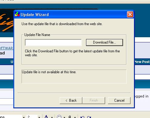

I have updated Signlab with all the profiles available, when I check for the on line updates I can either update form My Computer or the Internet. I select the internet, then I have a dialogue box to enter the update file name. I don't know what it is so I cannot download it.
As has already been said, I upgrade the Printer Manager to version 3.9 for the Versacamm and there is a large selection of MAX Ink profiles available.

By the way, one thing I needed to say was that when I pressed the Dowload file for the online update of Print & Cut, it displays the message, Update file is not available at this time.
I have attched a image showing the Print manager version and the Print & Cut update message.
Neil

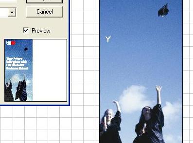

By the way I also attached an image of the .ai import. As you can see from the thumbnail and the image brought in, the text outlines are missing. I Sent these files via the suppliers sales guy.

Guidelines for exporting AI and EPS files
tdgraphics writes:<?xml:namespace prefix = o ns = "urn:schemas-microsoft-com:eek:ffice:eek:ffice" /><o:p></o:p>
Just as an aside, I had loads of trouble importing .eps and .ai files into Signlab, that issues is still unresolved and has been with the UK support desk for over a year. The sales guy at my supplier was the go between on that issue, I sent a CD with the files etc. The sales guy has since left my supplier, but I have not heard anything back from the UK Cadlink support team either directly or through the supplier.
<o:p></o:p>
Jackpine writes:<o:p></o:p>
I too have had issues with transfering files from Corel 10 to SignLab.<o:p></o:p>
Each method has not given reliabale results. <o:p></o:p>
Exporting as an EPS seems to work best. I have even copied/paste, cut/paste and used .ai esport.
<o:p></o:p>
<o:p></o:p>
<o:p></o:p>
  • As a general rule, export the AI file as no later than an Illustrator 8 version.
  • Something that needs to be understood is that AI files later than Illustrator 8 are essentially a PDF file with an AI extension.<o:p></o:p>
  • With respect to EPS files, there is quite a bit of variation in how a given application will export their EPS file objects.
  • You will see certain applications with the ability to "Save as" or "Export" earlier versions of Illustrator files. For example, in Adobe Illustrator CS choose File | Export, and then set the file type = Illustrator Legacy (AI).
  • Similarly, Illustrator CS has ability to export as an Illustrator Legacy EPS (EPS) file.
