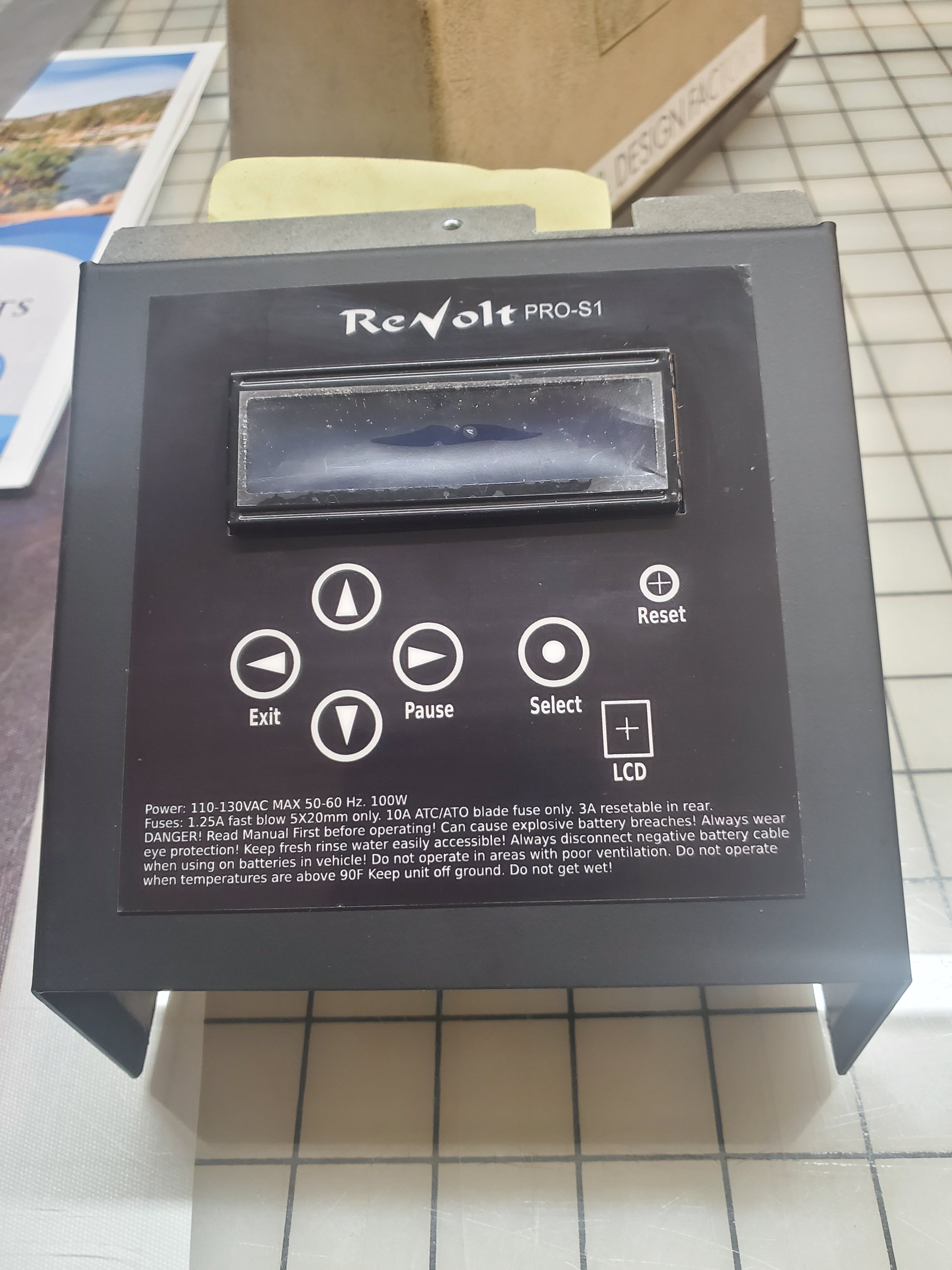

Geneva Olson
Expert Storyteller
yea. like this.
Geneva Olson
Expert Storyteller
I bet you they are looking for reverse printed LexEdge decals, printed on a Gerber Edge and backed with 3M 467 adhesive. They are scratchproof and permanent.
We do a lot of them for companies that make equipment that starts with a key, like generators, etc.
they are using them for covered switches in boats.

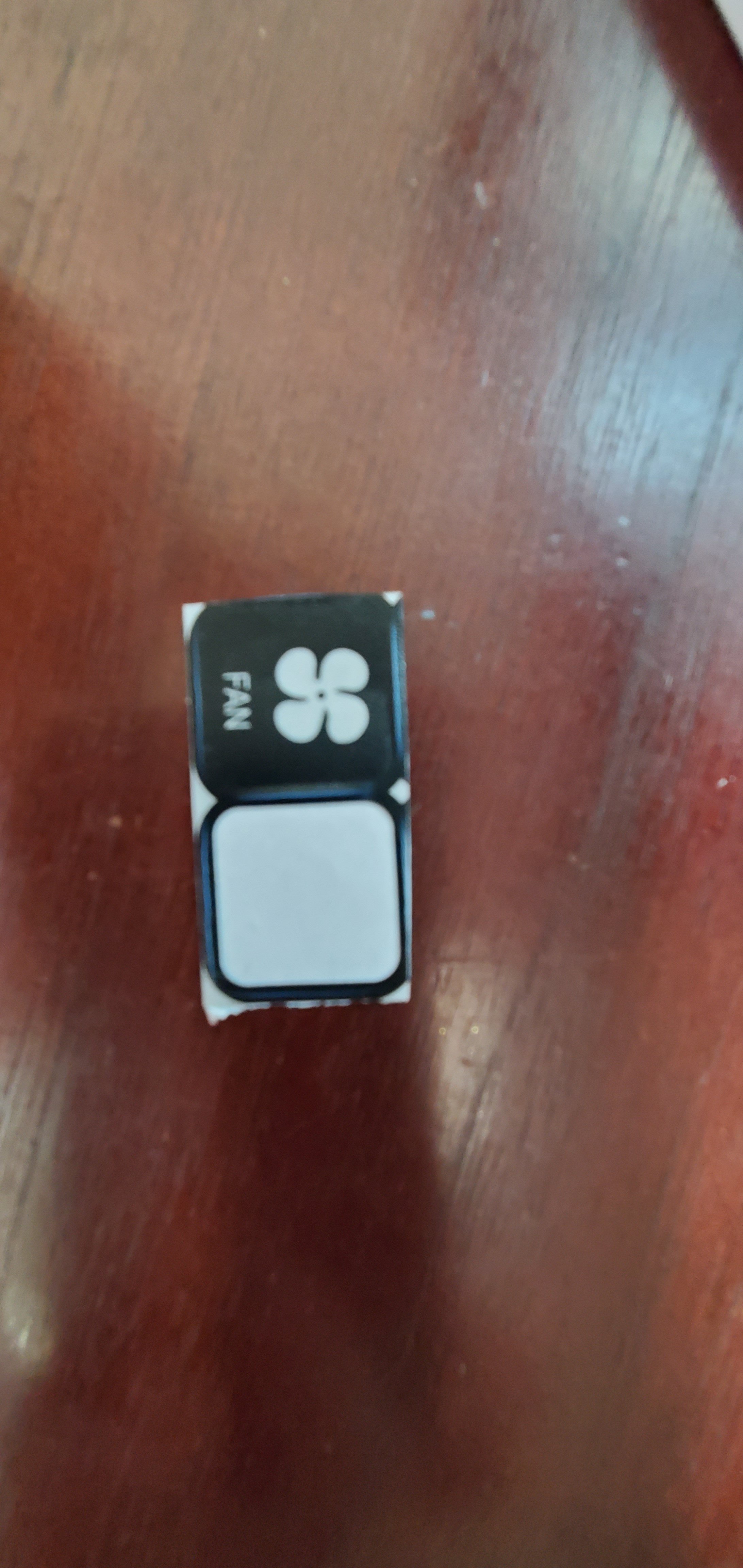

Sindex Printing
I print them on a 14mil synthetic stock with mounting adhesive on that back laminate the front and laser cut.
