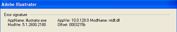

Any thoughts on what's causing this?
This happens on my Dell OptiPlex from time to time. (XPsp2, Dual Core Processor, 2 GB Ram, 256MB Graphics Card).
The problem occasionally arises when I try to access files in certain folders. The program will open the folder, show the files, and start loading the program icons on the left side of the file name then a dialog box pops up saying the program has encountered a problem and will now close. This happens in Photoshop, Illustrator and Flexi when accessing the same folders.
Now if I go into Explorer and copy/paste the folder to a new location I can then access the files without a problem.
Attached is the error report.

Be sure that you are accessing files from a local hard disk drive. Processing files in application across a local area network can sometimes (and only sometimes) cause random errors and crashes.
Bob
GK
are you trying to access these files across a network? the NTDLL.DLL file is the NT Layer Library and usually has to deal with networking and accessing remote files. Does this only happen in the one directory? if so check the folder properties and security on it as well.

I'm not accessing the files across a network, The folders are not protected with security, Yes it happens with different directories.

Scanned the C drive this morning. I also downloaded the CCleaner, ran it, rebooted and still have the same problem.
But here a little more info:
I noticed that when opening that problematic folder the program freezes in the same spot. I went into explorer and cut that particular file out. The programs then opened that folder successfully. The file is just a 1.5meg jpg.
I then tried to open the file I moved and that also opened fine. Put the file back in the folder I removed it from and the program crashes again. It always crashes while loading the icons on the left side of the file name. (AI & PS) I'm going to try a few more things in the morning.
