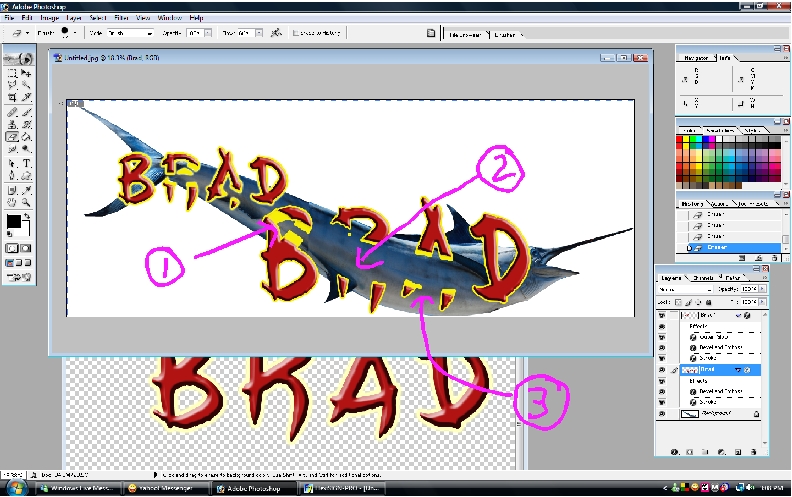

Here is what I’m trying to do.
<?xml:namespace prefix = o ns = "urn:schemas-microsoft-com:eek:ffice:eek:ffice" /><o:p></o:p>
2 layers, picture as background, text on top.
<o:p></o:p>
Apply bevel and stroke to text.
<o:p></o:p>
Erase a section of the text so picture shows through 100%
<o:p></o:p>
Steps taken
<o:p></o:p>
<o:p></o:p>
Apply effects tot text
Rasterize
<o:p></o:p>
Problem:
<o:p></o:p>
When using the eraser tool, the first (erasing) removes the text and bevel effect but not the stroke color which is the full size of the original text as in #1
<o:p></o:p>
Erasing a second time, (the stroke in yellow) works correctly to the background (#2) but automatically puts the stroke, (yellow) boarder (#3) around what is left of the text.
<o:p></o:p>
So, how do I make a clean cut / erase without
1 having to erase twice
2 not having it automatically filling the edge of the text with the stroke?
<o:p></o:p>
<o:p></o:p>
Thanks for any insight you may have.
<o:p></o:p>
Bradster.

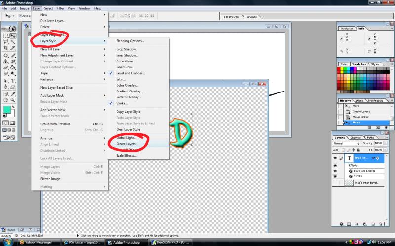

cgsigns_jamie
Select the Text layer...
Then open the Layer Menu > Highlight Layer Style > Select Create Layers
What this will do is separate each effect on to individual layers. Then you can select those layers and merge them into one and you should be good to go.

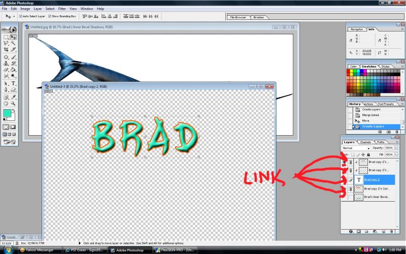

Next, link the layers you want for the effect together.
attachment.php

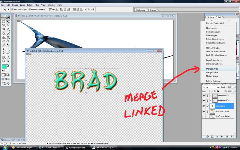

From the Layer Palette fly-out, chose
Merge Linked
attachment.php

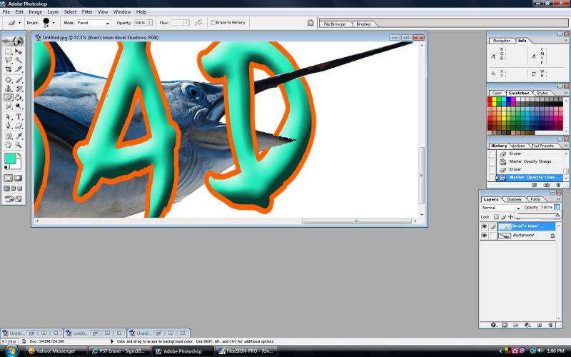

Now you can use the eraser in one step without unwanted effects.
