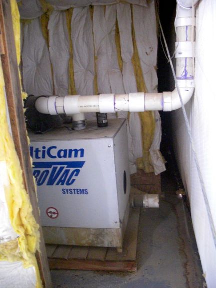

Doug sorry I didn't see your questions sooner. I haven't had a need to control the temperature at all. I've been using this setup for the past five years now. Outside of doing routine maintenance, changing pump oil, greasing, and keeping the air filter clean. Everything seems fine. I know the temp must get pretty hot inside. Florida during the summer is hot anyway and then all the heat inside the small room adds to that as well.
Here's a shot with the door open. The door does have an open space at the bottom to help circulate the air inside. I don't even have the exhaust going outside. So far so good.
