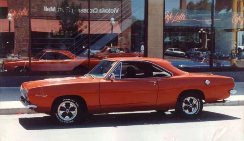

Mopar dude, after seeing your username...
-My '67 Barracuda on Grand Ave. Wish I still had her.
There, I'm done now, sorry for the hijack!
