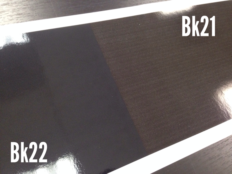

1: Finally ran the printer onto the takeup. It's tracking perfect for about 50' then walking again. When I say perfect, I mean perfect for 50'. Then all of a sudden it just starts dipping left and right. It's almost as if the weight affects it.
2: Roland is coming out next week again. They have been in great contact with us and working to resolve the problems. I'm not getting great printing on my blacks even with roland spot colors. I don't think heads are good. See photo. Hopefully it all works out.
