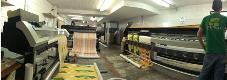

juf1an
I have a roland rs 640 and latex 260,
The print cost on hp its more expensive, the ink x6 tonner 600us, printhead 600us, i have use the hp two years ago (6 print heads, 4 cyan 1 magenta and 1 yellow). It prints the 10% of all my production.
The print cost on my roland its cheaper, the ink 50us (sts ink) x 4 colors , print head 1500us (only change one), i have use the roland 4 years ago and it prints the 40% of all my production
The 50% off al my production its printing on my konica 520 of 3,2mt really good machine but solvent.
my machine room ;)

ams
my machine room ;)
That is quite a printer room.
Christian @ 2CT Media
my machine room ;)
That's a very apples to oranges comparison. You are saying the Roland is cheaper by quoting 3rd party ink and parts to OEM HP. Why not compare STS to STS which is the same price for latex or solvent?
