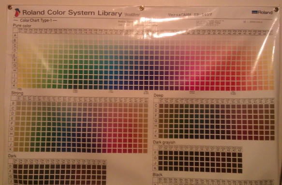

I have to use the Roland Color System Library to get the correct colors on vectors. I noticed on your coreldraw export picture that the only color pallette you have showing is cmyk.
You have to print the roland color chart out on the media you use the most in versaworks and select the color from the chart, Colors will look different on the monitor unless you have the monitor calibrated right.
You mentioned that the dark blue printed correctly but after you lightened it, It went to halftone look.
Sounds like you are giving the colors percentages and that will produce halftones. 50% black will be grey on a white background.
Hope that helps and good luck.
