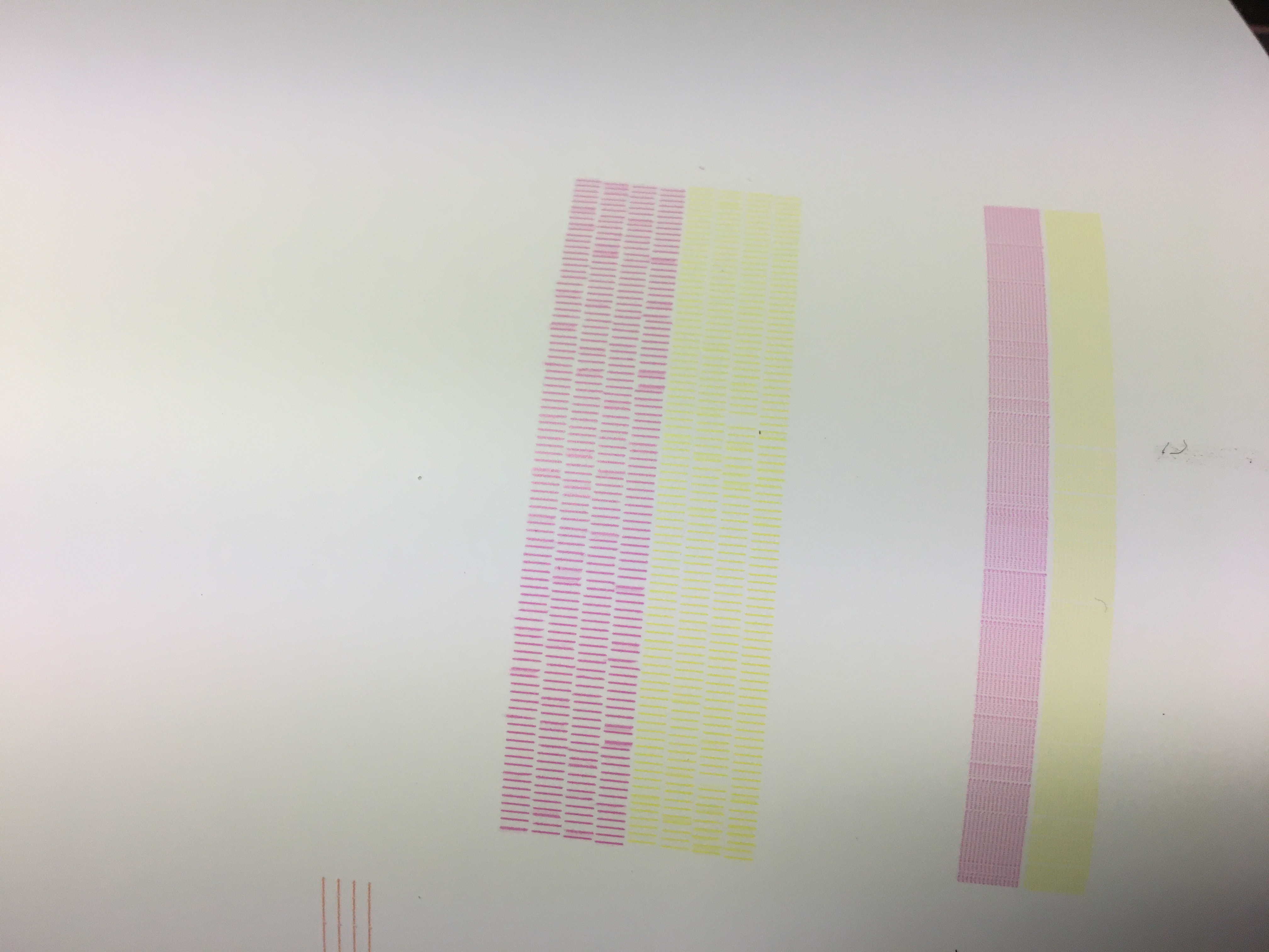

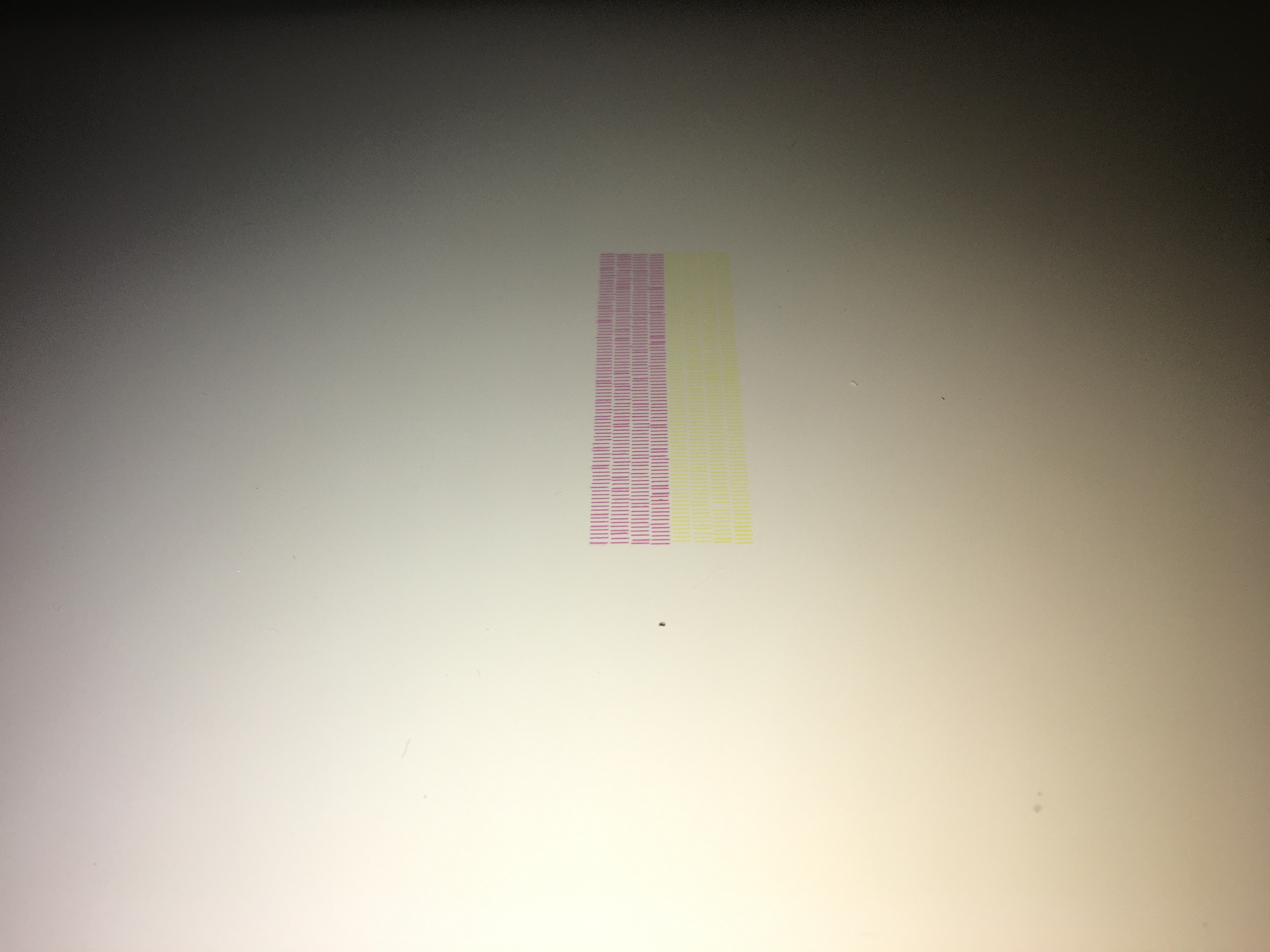

    Hi Daniel,
    I'm having the same issue. Did you have any luck fixing the problem? I replaced the manifold on my H1 Blk / Cyan and had it printing but after running cleaning fluid through the lines & refilling inks this is what I'm getting via test print... its doing weird stuff, first test image is yesterday and second is this morning...

  8. Sean@CedarHouse
    Sean@CedarHouse Printing Money
    40
    3
    8
    Sep 22, 2020
    Beaverton Oregon
    Before jumping into fuses and electrical issues (The Rabbit hole) make sure you have ink through the print head. Replace the cap, put the heads in the home position and then pull ink with a syringe. Once you get a healthy amount of ink in the syringe, put the cap hose back on the pump and do a medium clean. Then test. Most in drop out , even after a head replace is because of ink flow and not an electrical issue. Usually.
