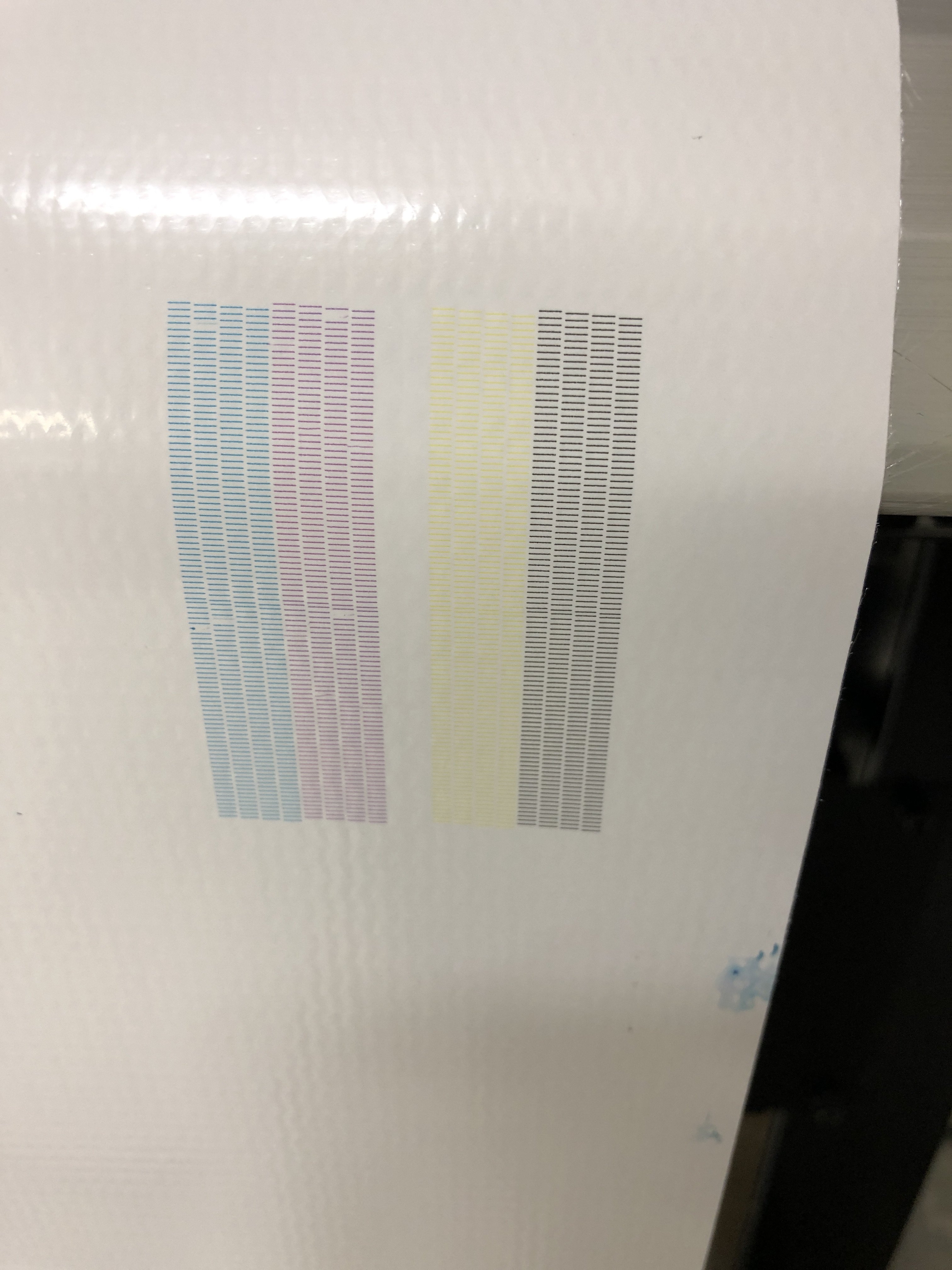

Other than some missing nozzles, which wouldn't make prints any darker, and your feed adjustment needs to be increased, the nozzle test looks pretty good.

Ok thanks so much, service guy is a week out and 3 hours away from me !! Of course I have a huge workloaid this week ,.. did you see the pic of the nozzle test ?
