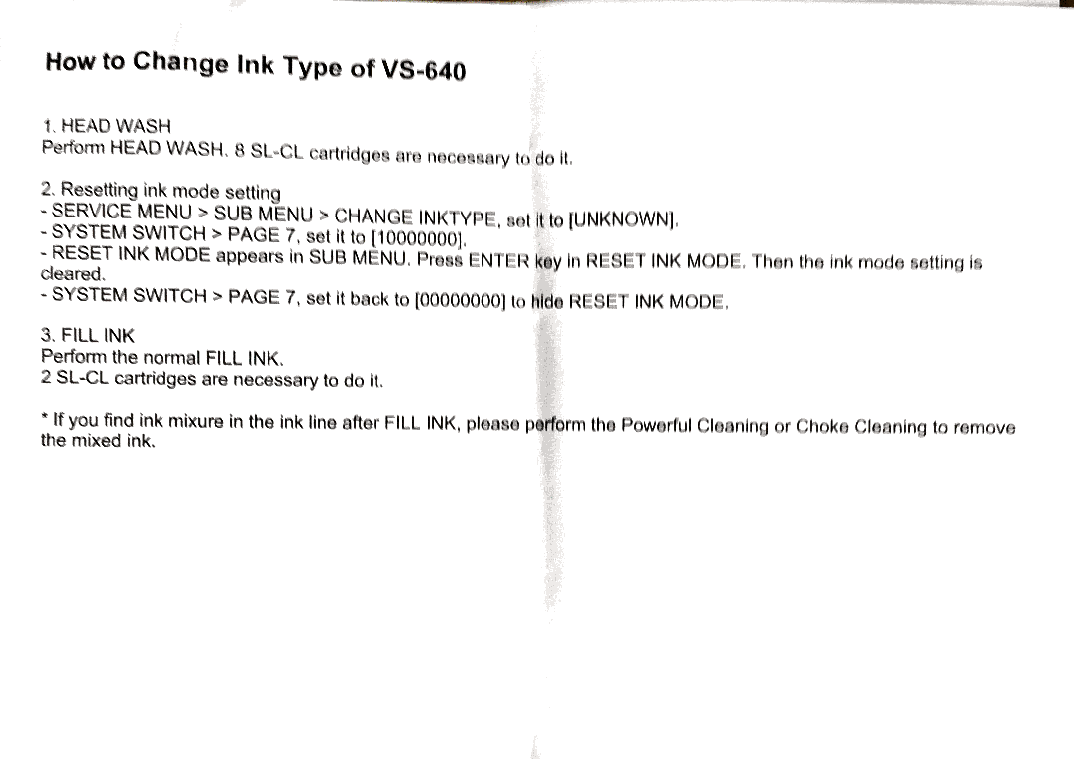

changing roland vs-640 metalic to dual cmyk
at last did manage to covert vs-640 metalic to dual cmyk. you dont need the service manual to do it, but you have to enter the service mode to change the ink type, you will find three option, metalic, pigment 4 colour and unknown. this is where roland is trying to confuse you. you will automatically choose pigment 4,which the machine will accept but verseworks will not communicate with the machine. you must have the option of ecosolmax selected otherwise the rip will not comunicate. roland has not given this option so that you dont change. managed to get afile that you have to send to the printer to erase the memory and install the dual cmyk with all the options. if you are intrested my email address 1s odhisteve@yahoo.com. i did change the machine yesterday.

I have a vs-540 with dual cmyk config. Id like to clear the memory and select the cmyk lm lc mt white believe thats correct, if i am off a color its whatever config has metallic and white. Please email instructions how to complete this. Mainly the memory clear procedure as the printer is fully cleaned and ready to accept the new ink colors. Thanks !
here you go this is correct way
