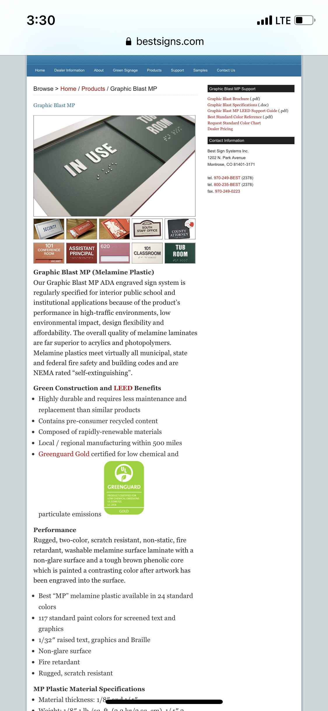

Thank you for the replies. I think maybe I should offer to show you some links of the signs I am talking about.
https://www.bestsigns.com/prod_gbmp.html
http://www.mohawksign.com/specifications/specifications.cfm
