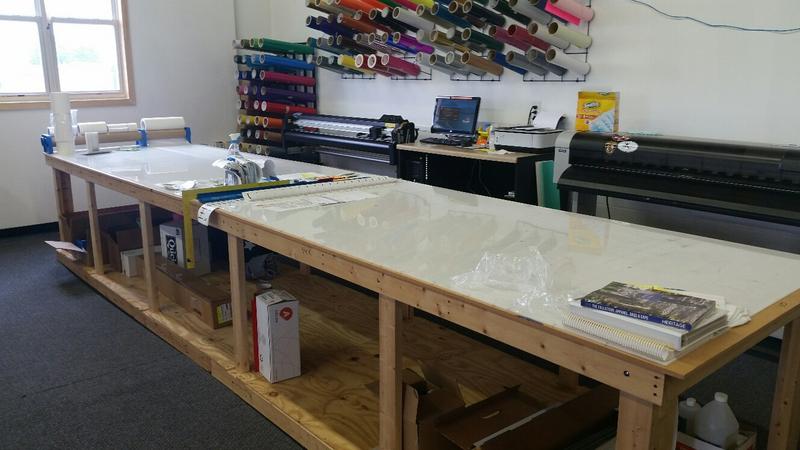

Our 49" X 18' table and 2 others a 51" X 99" and a 51" X 123". We prefer to use acrylic as a topper it's rigid enough, soft enough to cut on and can be flipped over when the groves get to deep. The 51 X 99 has drawers on one side for media storage and whatnot, they just slide in and out mounted on 2 X 4's with a 3/4" plywood as the drawers.
The 4 X 18 has a 1/2" MDF as the base, super rigid then just double side banner tape to hold the acrylic in place. I have yet to fill the the bottom of the tables with to much junk yet, give it some time.....

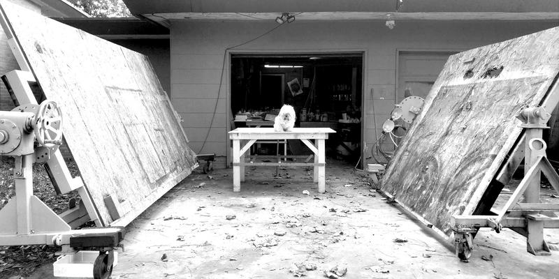

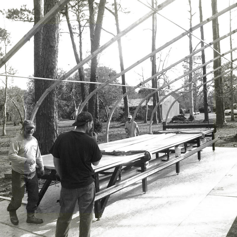

one thing i forgot to mention that is truly a ridiculous thing that has spoiled me. i have to giant rotisserie tables. a 7' x 14' and an 8' x 8'. they are from an aircraft manufacturer (was told they were used to make jet fighters for the vietnam war. the 8x8 is actually a trapezoid in the shape of the plane's tail.) i chopped and modded them to have decks. i've had giant pieces on them and can just walk right up to the middle.
aaaand i have a 7' x 24' foot vacuum table that i have yet to modify for architectural panel lay ups. right now it's just a work table.

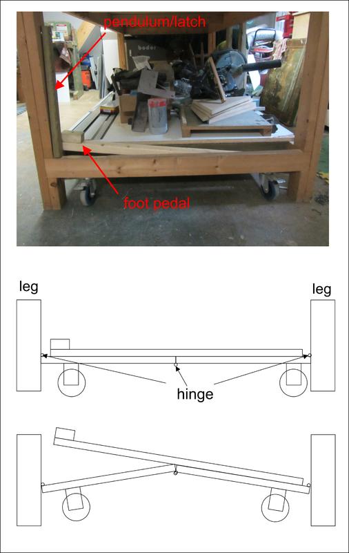

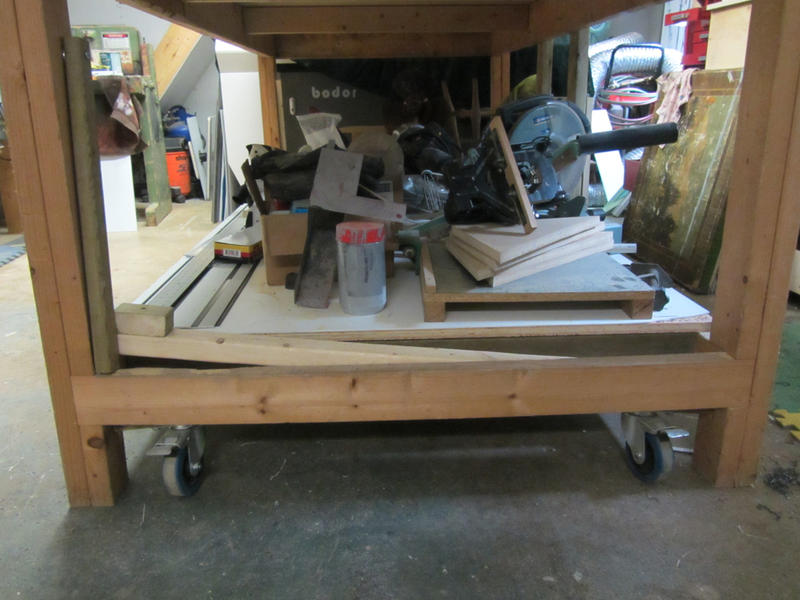

Artbot wins! But I have the slickest wheel/lock setup. My table lifts up 1/2" onto wheels when I step on a foot pedal and automatically latches there. Then I can roll the table to where I need it. Another step on the pedal, release the latch and the table lowers onto its legs. Nice and stable because the table sits on it's own legs not on locked wheels.
The mechanism is made from 6 door hinges and some scraps of 2 x 4. When you step on the pedal a pendulum swings into place and latches the foot pedal down.
You have to lift each end of the table separately, although it can be geared up to do it from a bar that joins the 2 foot pedals.
I've attached a drawing of how it works.

Very nice setup. The step is a really cool idea. How hard is it to press the pedal down and get the latch locked in. It looks like there is a fair amount of weight there.
signmeup
It's about a 38" lever and it only lifts 1/2" so it's pretty easy. It also only lifts 1/2 the table. I can do it with my thumb.
