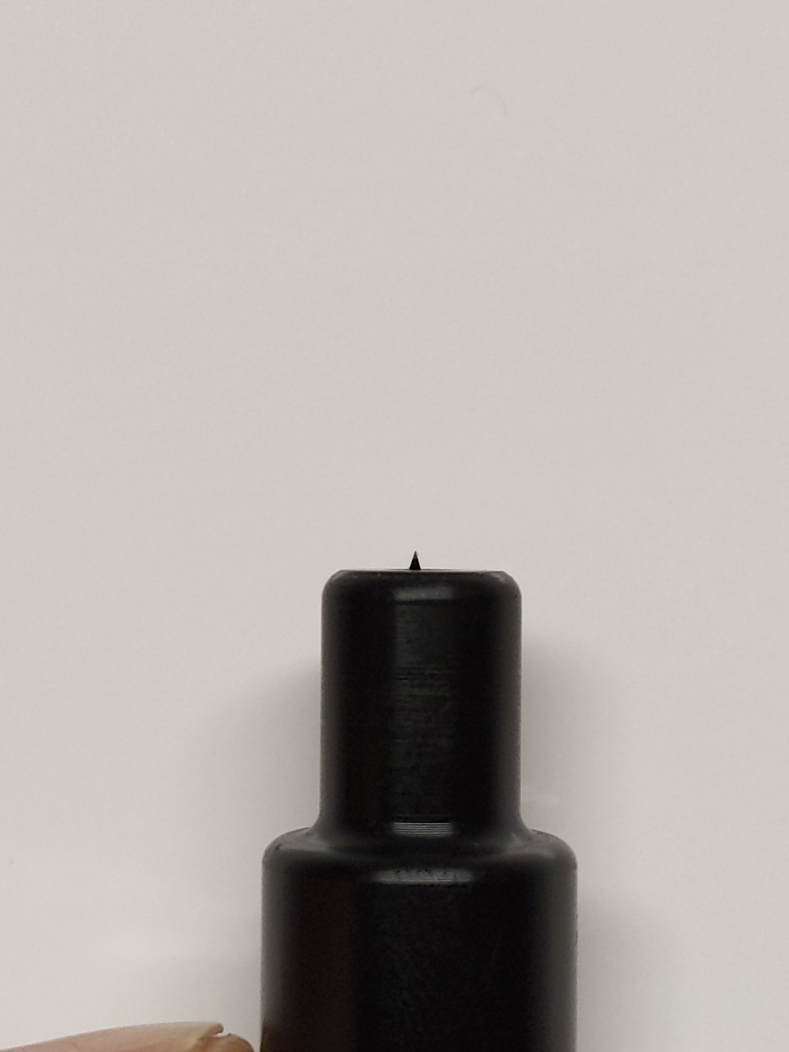

    According to Summa I've ruined 4 blades and my cutting strip in a matter of 2 months. They say my blade is extended too much and my pressures are too high. Any discoloration of the cutting strip means it need to be replaced.
    So if you do one Flex Cut run and it scuffs up the strip it's bad?! If I'm correct Flex Cutting, the blade will touch the strip, because well you're cutting through.

    Well with the blade pictured I was cutting Kiss cutting and flex cutting 3.4mil vinyl and of course through the backer. (I don't have a micrometer so I'm not sure of the thickness of the backer.) Most of what I cut is the 3.4mil with a 3mil vinyl. My Flex settings were 275/135grams (Full/Flex Pressure) I know it's high but if I had it lower it wouldn't cut well. Should I use the 55deg blade? When I'm cutting through laminated material my flex settings are 310/185grams (Full/Flex) again the tech said that's way too high. I've tried lots of flex lengths. I've seen other threads and went down to 1mm/.5mm, mostly I hover around 7mm/.7mm.
    I've got new blades coming and I'm ordering a new strip.
    I can't see that this is too thick for cutting but because I don't l know these machines well and never actually had a human here when I had everything installed, I'm just not sure anymore.
