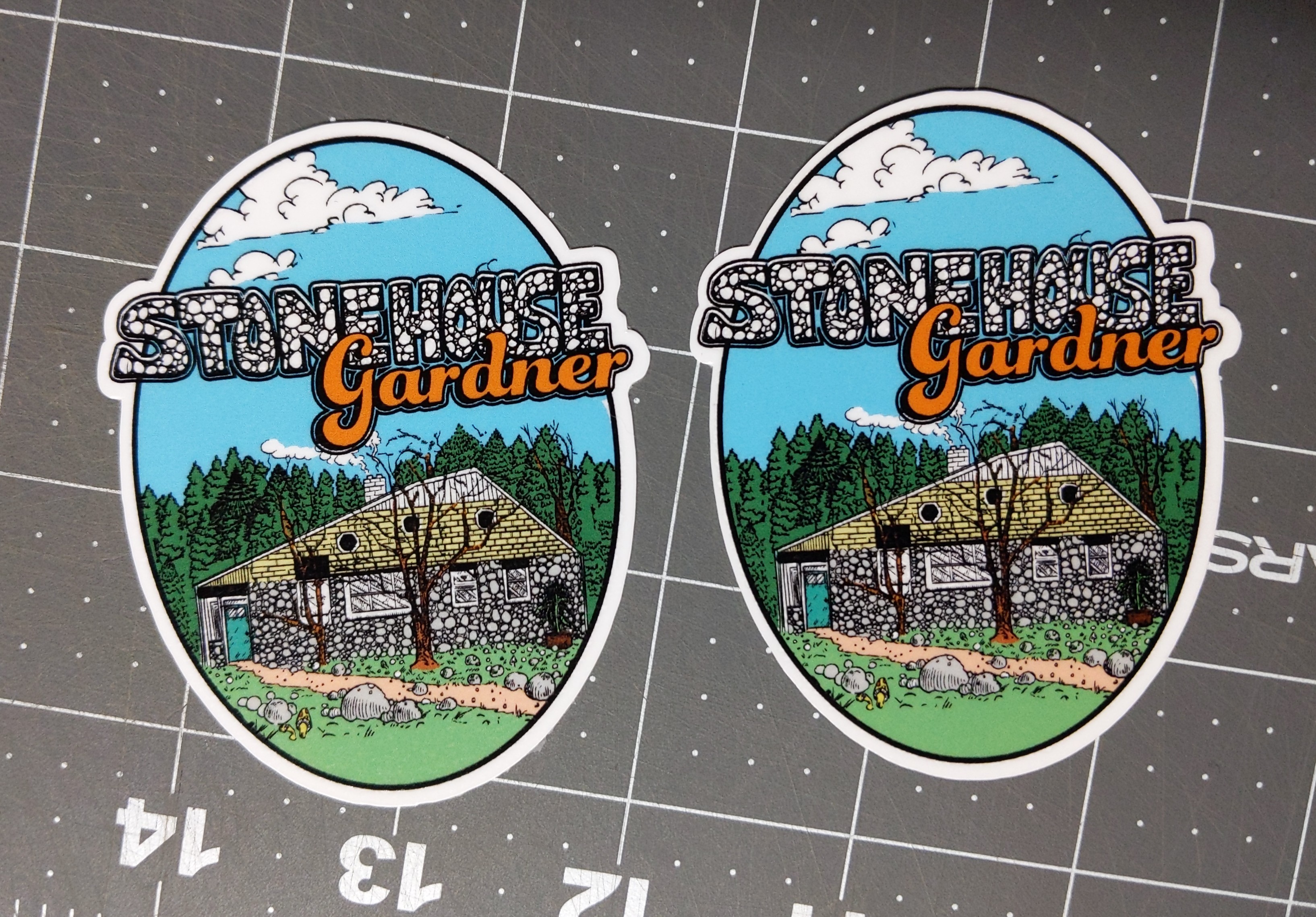

I do a kiss cut, then a perf cut .2" out... I already kiss cut this whole roll (Took 30 mins to kiss cut 150 ft, however the decals are huge). I like to perf cut .2" so they can crack and peel the stickers. but yes, it was kiss cut first.
It'll kiss cut, then ask you to switch the blade and then do a perf cut on the graphtec as well. Not sure if theres a way to do it on the summa... but the graphtec will kiss cut, switch blade, then perf cut all while reading the marks once, if thats what youre talking about. we dont do it that way because we dont want to constantly switch blade positions though.
