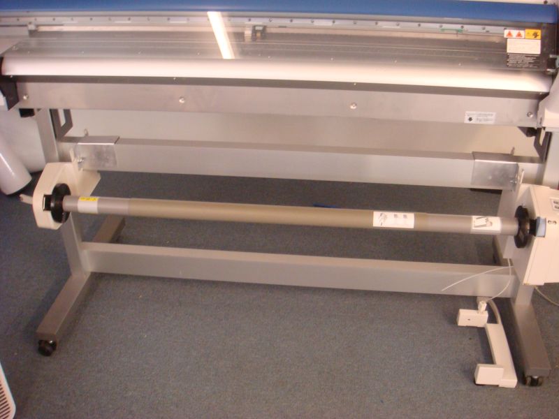

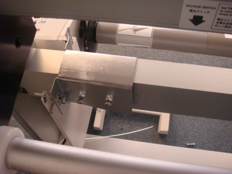

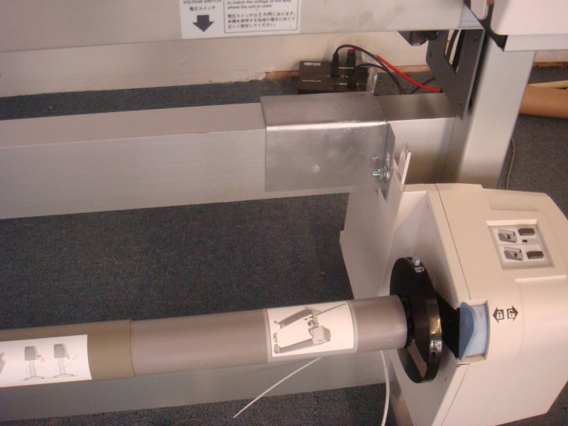

yeah the only downfall i see for my el cheapo

^^^ Sorry to resurrect an old thread, but Tim, how's the "Wind Up" working? Still flawless? If/when I get my new SP300i, I'd like to also get a take-up, but the Roland one is $2000.00! I see that this one is now listed at 395.00 British pounds.
I just learned today that you can't do the "cut" part of "print & cut" with a take-up reel; you have to do the print, then manually wind it back to do the contour cutting! Is that true for the "Wind Up" brand as well? That seems like a huge drawback.

It is still working very well. The only little hassle I've had with it is the core insert slipping within the core, but that was because it was set to wind too tight by one of my staff. It wore out the core insert slightly, so now I simply add a little masking tape to hold the core onto the insert so it doesn't slip. Hope that make sense!! :rolleyes:
As far as reversing to cut... I haven't had a problem with that. If the wind tension is not set too high, it gives enough for the Roland to pull it back to cut without issue. Just make sure if you don't use a long leader to use a low tack masking tape to tape the vinyl to the core, otherwise that will cause an error when it tries to pull it back.

You can just use any old core! That's what I did. It does come with a core, but after discussing the extra shipping cost just for a core... wasn't worth it! Actually, one could take a heavier-duty core and actually put a couple self-tapping screws in each end through to the insert. That would solve any slippage problem!! :rolleyes::rolleyes: Thanks for the idea Colin... well, your post somehow gave me the idea anyhow!!:rock-n-roll:
