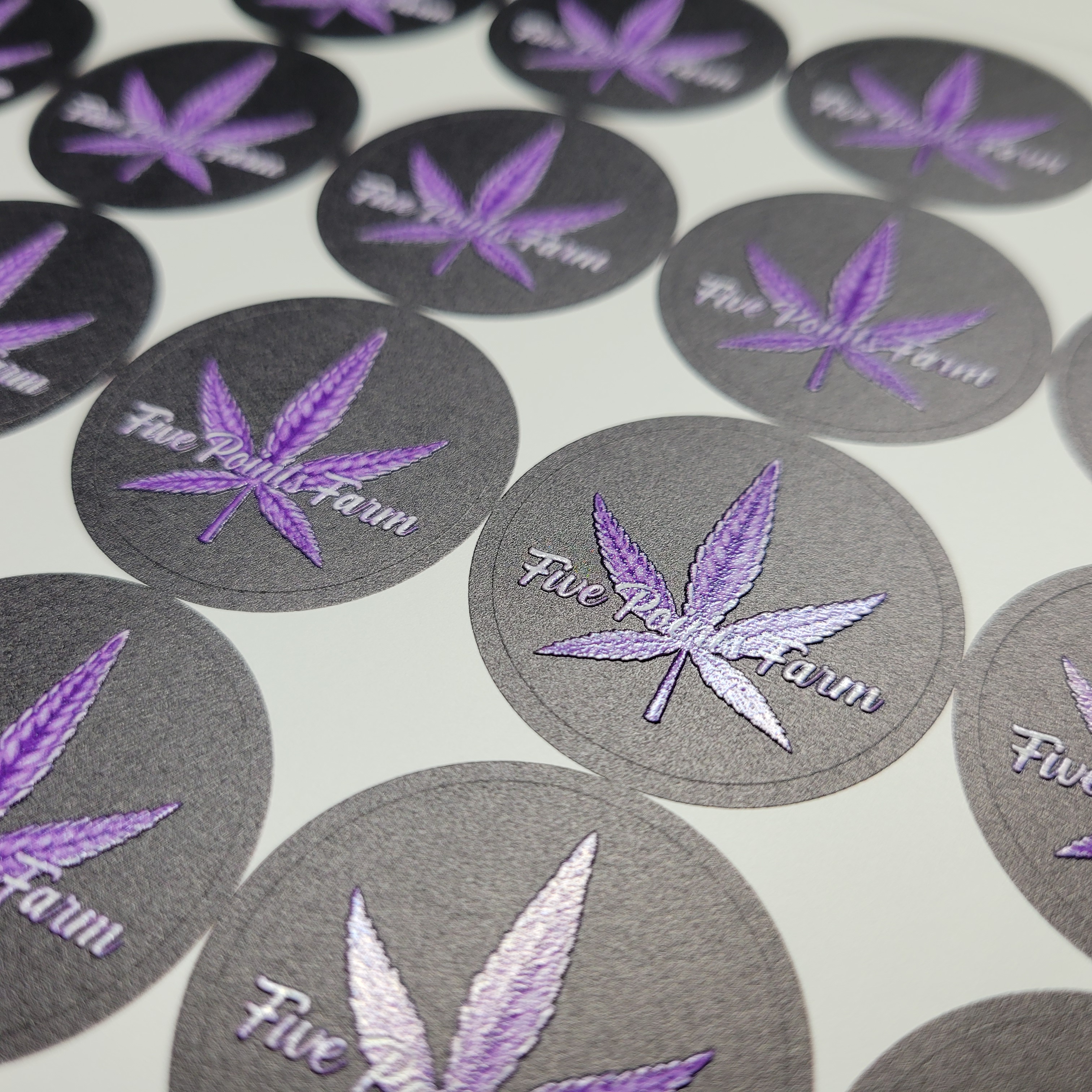

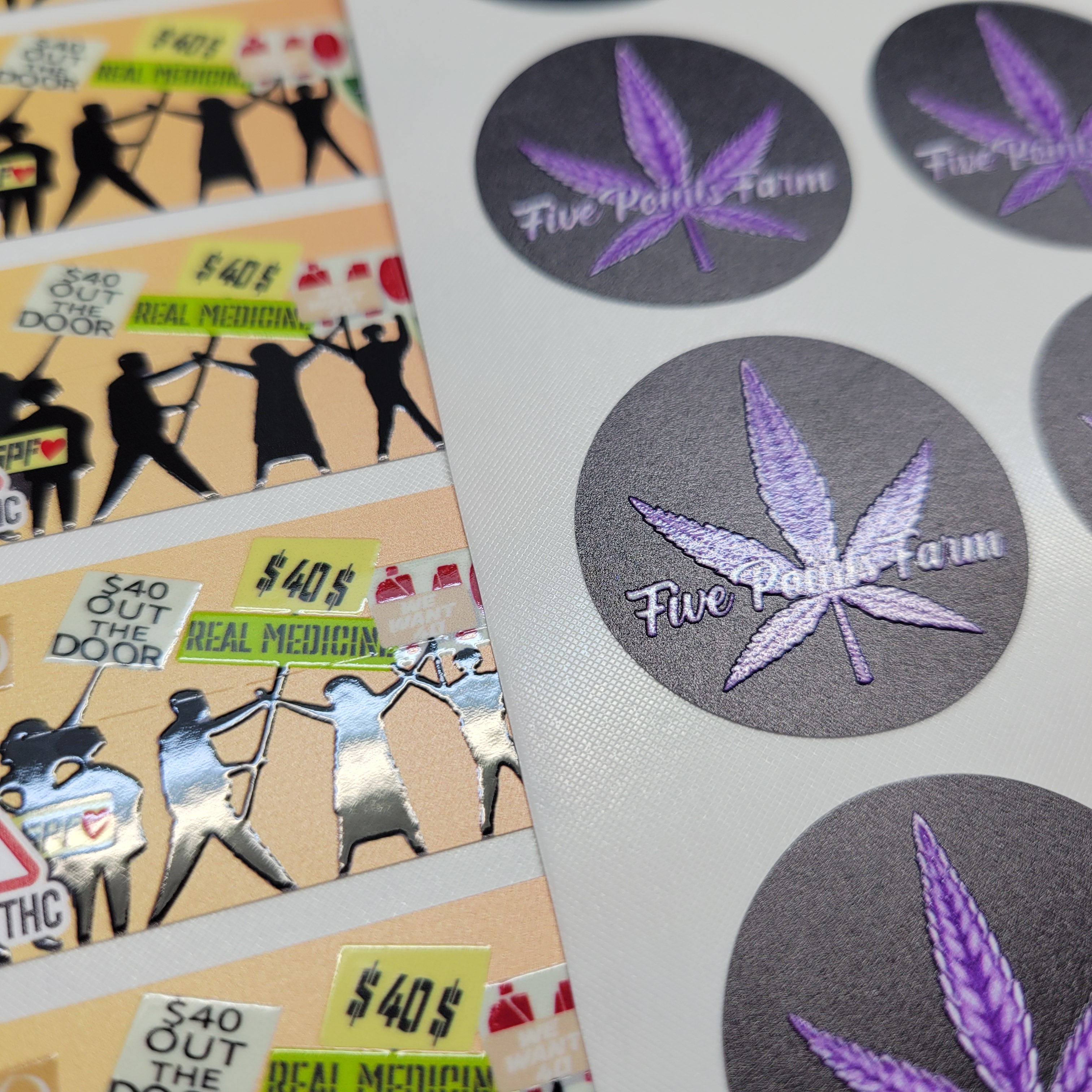

One thing I did notice about pull back printing is that the gloss doesn't lay down the same was as doing gloss in a single pass.
I did these tops with a build of color/white and then pull back to add gloss, the difference is noticeable and I'm not sure if it's due to the elevated print or something else.
