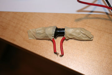

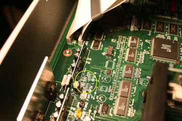

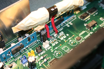

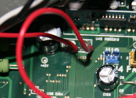

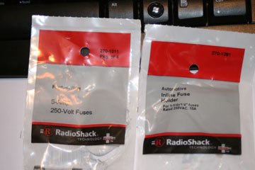

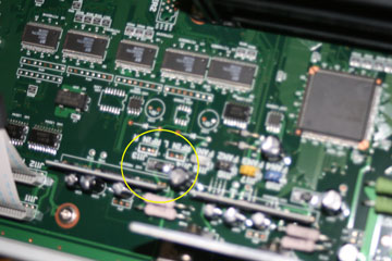

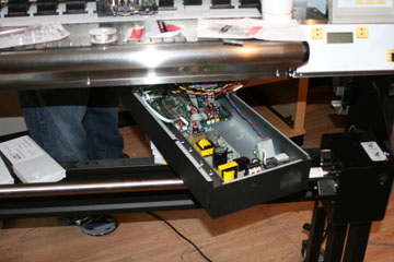

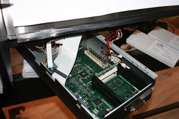

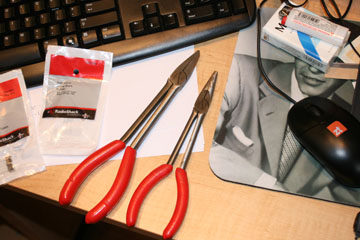

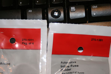

Pictures of changing the head fuse... Thanks Headhunter for the specs and info on how to change the fuse!

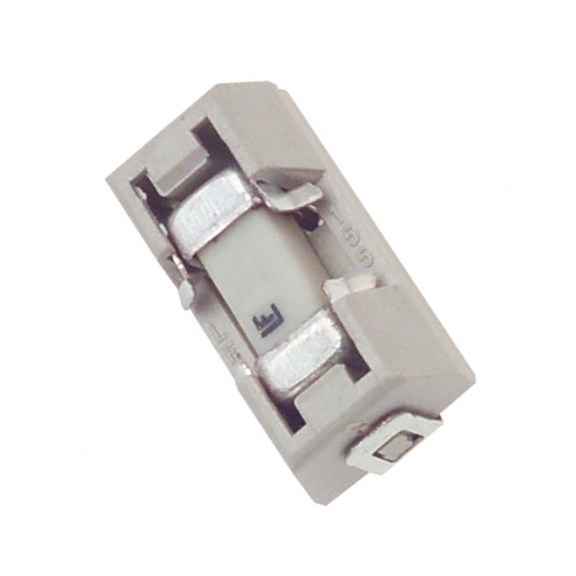

Part# 0154002DRT 2 amp nano
Part# 0154005DRT 5 amp nano
Available through Fuses Unlimited

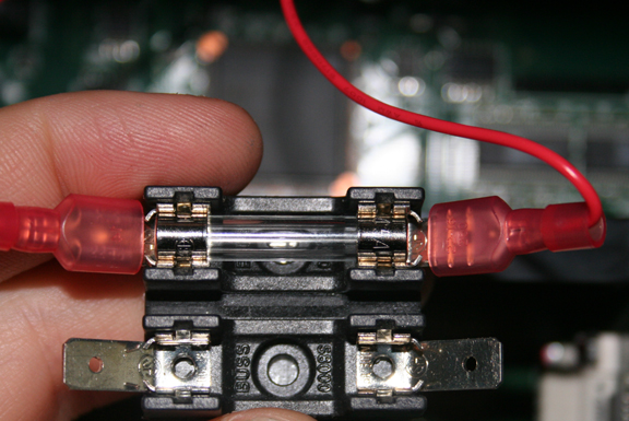

So are both fuses 5 amp? :help
I used a 2 fuse holder so if the other fuse blows I'm ahead of the game. I attached some pics of my mod.
Thanks for the great thread! :goodpost:
