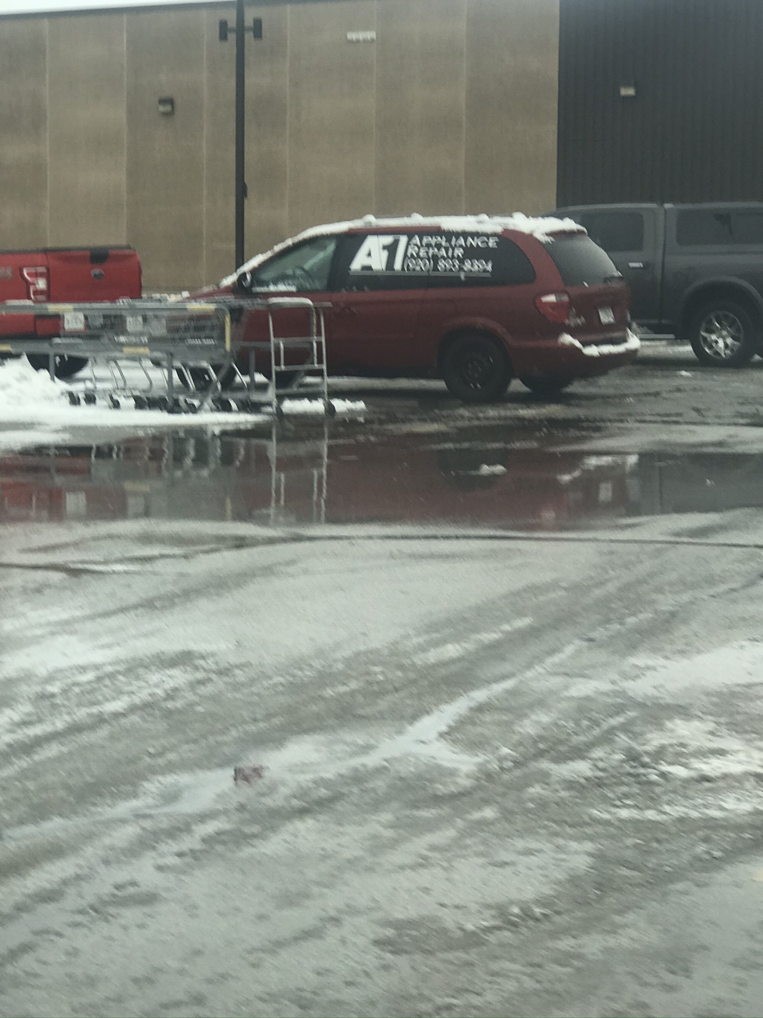

Thought of this post on Saturday and had to take a pic!
Johnny Best
I feel bad for the guy, probably got ripped of by some sign guy for that and then driving around in a maroon van with no hubcaps. He is just trying to make a living.
That probably was the wife driving to the grocery store on a cold wet Saturday, while he stays home watching their four children tear the house apart and he tries to repair a toaster oven on the dining room table.
