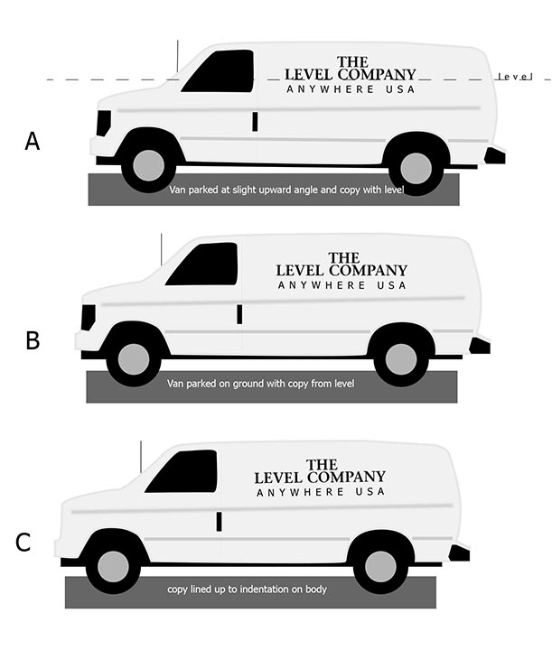

Great demonstration! It is easy to see that version B has the best harmony with the vehicle. The text lines up with the bottom of the vehicle, the lower trim molding, and the bottom of the window. Version C just looks like somebody just stuck it on by eye - it is a compromise and just looks amateurish. Version A is just a stupid mistake.
Show that to a customer, and they might choose version C because it "somewhat" lines up with the body panel indent. Then you will need to explain that a diagramatic representation will not represent the overall look of the final representation necause it emphasizes different details and the image is isolated from any kind of environment. Furthermore, the client has little criteria for judging how a graphic presentation should look, and tend to look at the most obvious things (such as how a graphic lines up with the nearest element of the diagram and small details in the design). Out in the wild, people will view the graphic outside of the context of the vehicle, and the relationship to the vehicle would be a very secondary observation.

I used a level once and ended up having to re-do the entire van. Now (Like Johnny Best's picture) I use one of the most level looking body lines and pick somewhere in between this line and level, stand back and if it looks good, I know the customer will be happy. Level means nothing if it doesn't look straight.
