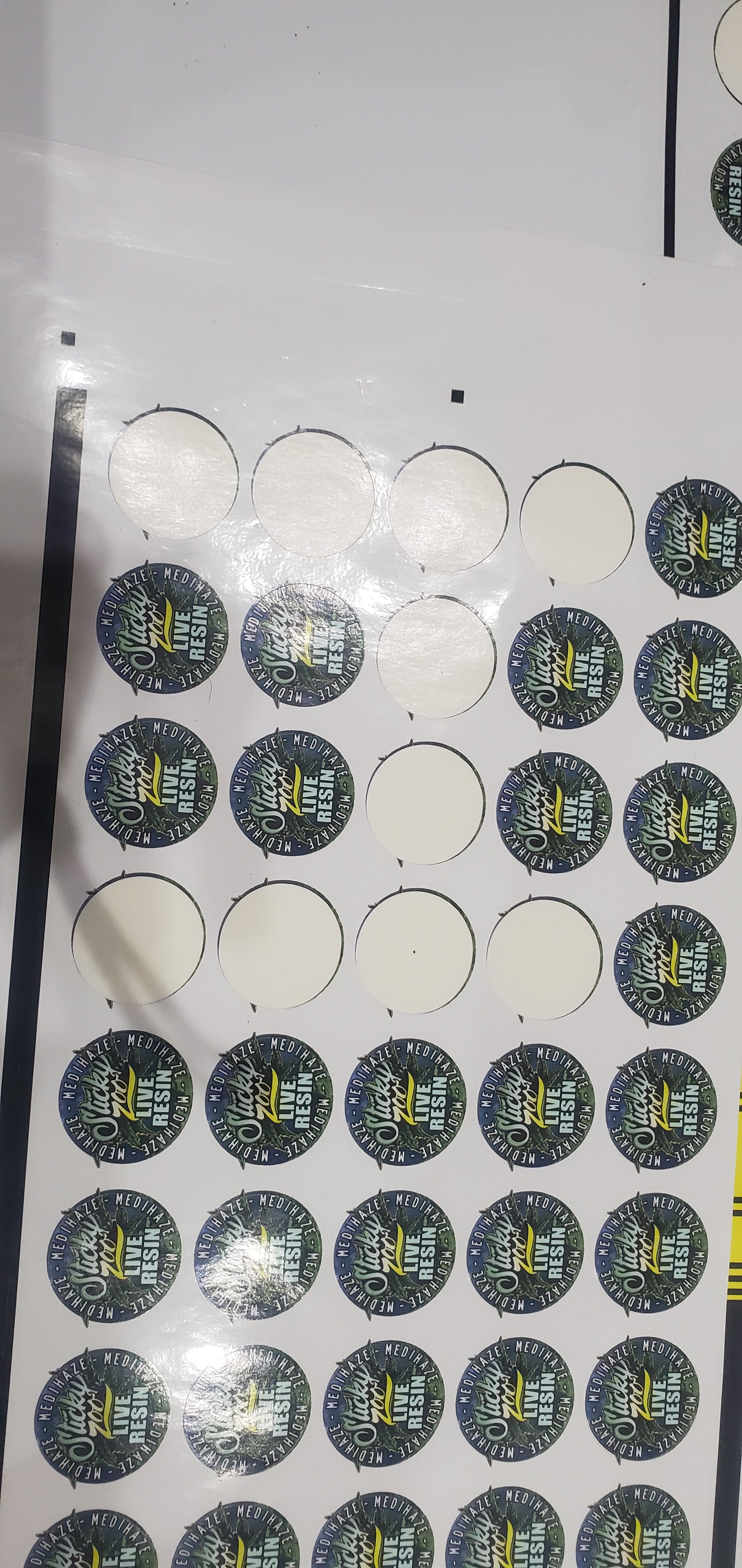

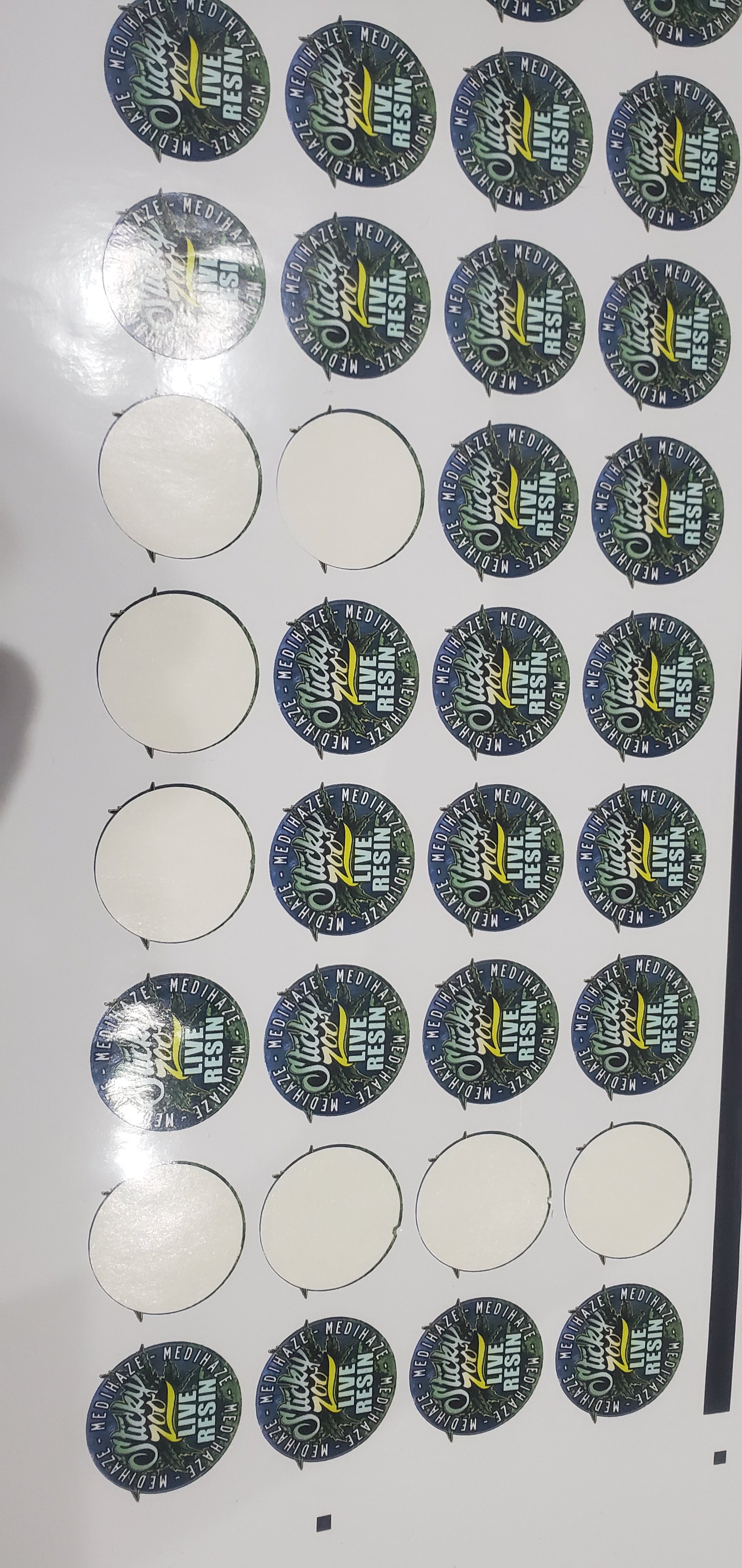

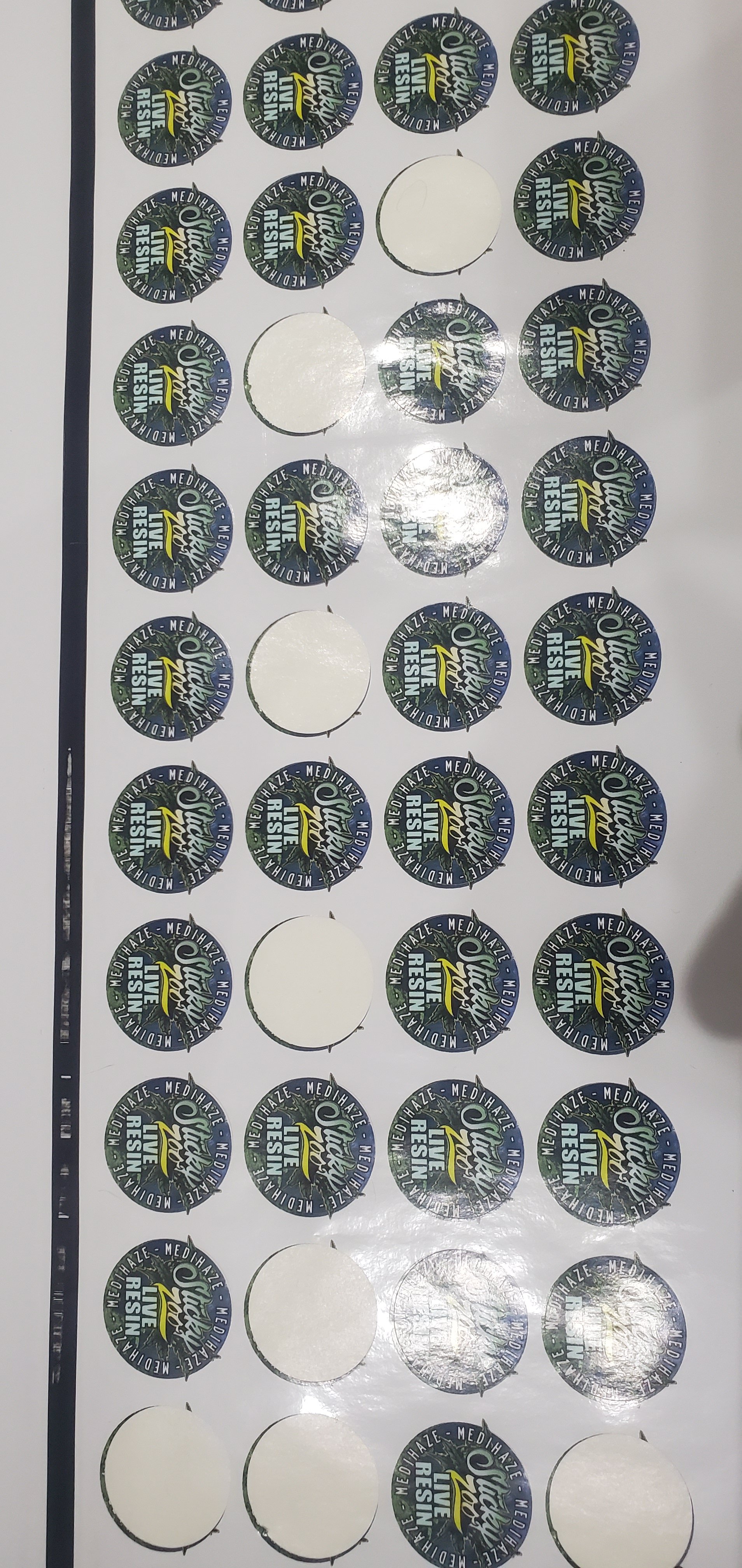

It's a summa cutter, I also think I'm doing something wrong but for the life of me I don't know what. Everything is calibrated, black line for the sensor is straight no bowing, cut lines are correct, only running 20 stickers at 1.25 inch the bleed is very small because the text wraps around the circle and cut line is basically on edge of text. Using a avery MPI mono film but I just bought a 3m higher end film for testing. Rolland cuts these so perfect, done to perfection!
Micheal
Here are my results with 3m, still off the cutline.

looks fairly consistent so i would go back to cutter off set settings on 54 " material i use all the pinch rollers i got for cutting

Why don’t you adjust the graphics a bit and give yourself a little more bleed room also.
My 315 cutter is very accurate but I still like to give extra bleed

Yes I do these type of labels a lot. I would adjust the text inwards a bit to compensate too.
Also how far of feed length do you do each set? I tend to keep my long run label jobs in sets of around 36” in the feed direction this will help keep it more accurate.
I just did 10k in 3”x2” that were contour cut in an uncommon shape and there was no visible off tracking.

Did you set up the offset of your blade correctly? May sound stupid, but since you have no bleed you may be missed this one as well. I also see that the cut line is misaligned but consistent are you sure you didn't move the cut layer by mistake in corel? If not you may try to move it to compensate the misalignment since each circle is misaligned in the same direction.
