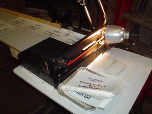

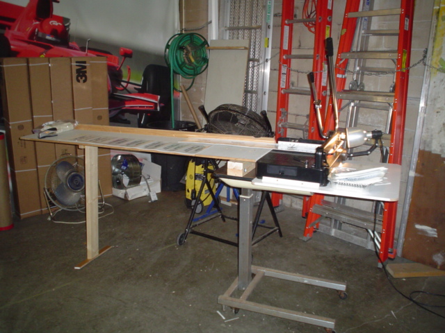

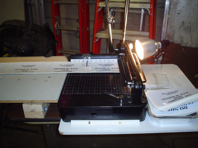

Heavy duty parallel blade guillotine - staple strips together- cuts
very fast. About $200 I think
