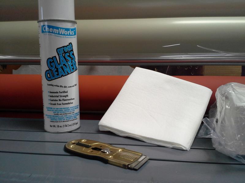

This is what i use.
If there is any large amount of adhesive to be removed i will first use some rapid remover.
No need to turn glass cleaning into a science.

Do you wipe it down with something afterwards? I know they say to not use glass cleaner, then right after put your vinyl on because the glass cleaner can leave a residue.
The glass cleaner i use does not leave any residue. I have been using this stuff for over 20 years. First at the shop i used to work at and in my shop since 2002. Never had any problems with adhesion. I also use this stuff to clean vehicles. Although on vehicles i also do a quick wipe off with alcohol after.
I buy it in cases from a company in Cleaveland, Ohio.
