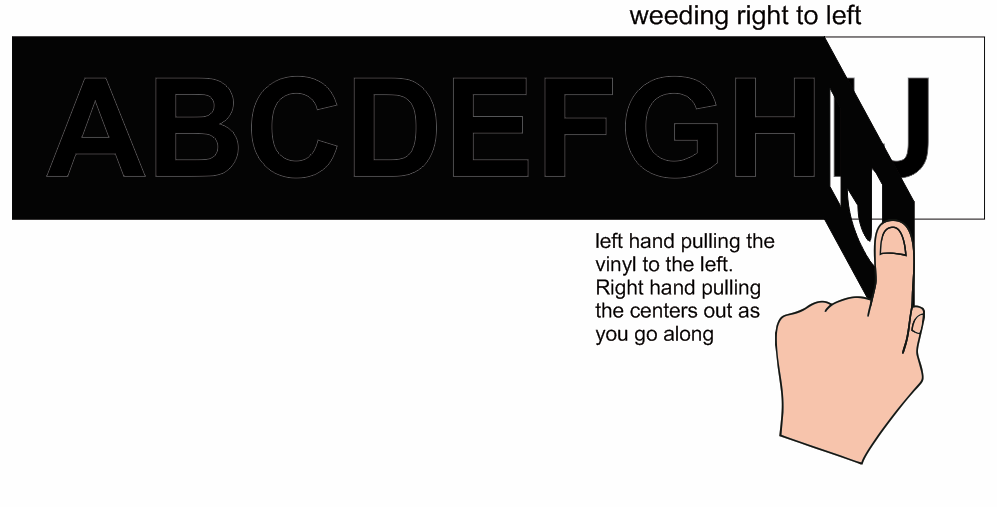

Go figure. I'm left handed and have almost always weeded right to left because I like being able to pull the centers out with my left hand and dental pick while pulling off the excess with my right..

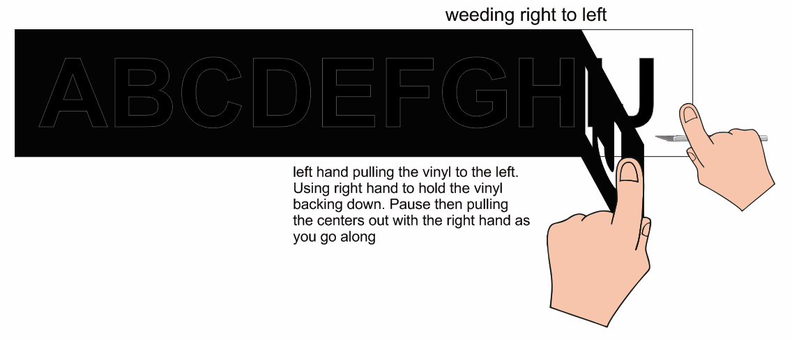

I don't see how you describe is even possible. What hand holds the vinyl backer down.

Could it be the difference between left or right handed person? I like going right to left because I'm right handed and I keep an xacto in my right hand while weeding. I'll sometimes just pull out the centers as I go along.
I am left handed.
I just rest the side of my right hand on the backer, giving me plenty of articulation range for the x-acto knife in my right hand fingers. Left hand holds the weeded vinyl, and I sort of "snap and wiggle" the vinyl as I go, paying close attention the upcoming letters as they all require a slightly different approach.

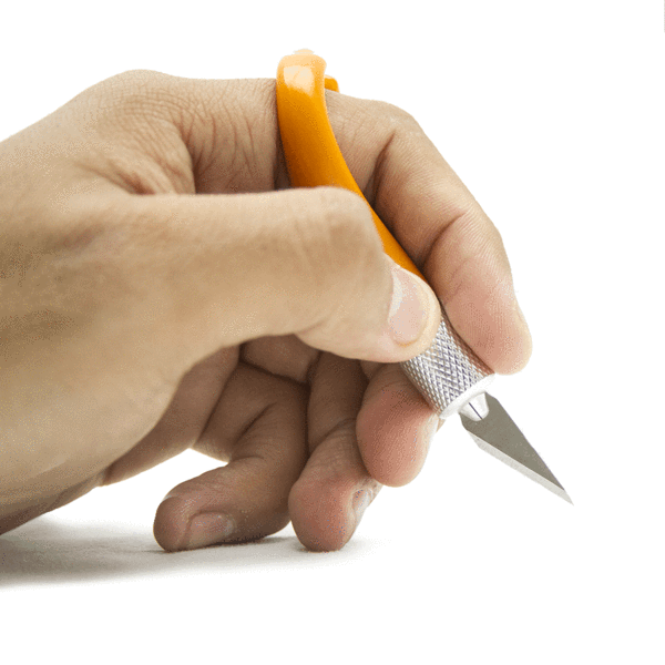

I use a Fiskars knife like the one shown below. Done correctly, I don't even need a separate tool to hold anything down.
