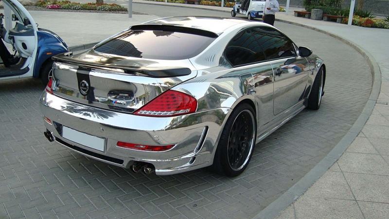

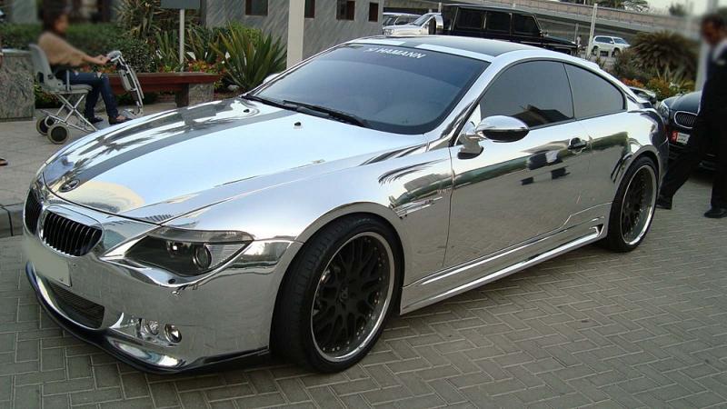

is it wrap? and which material is it u think?

If it's a wrap then it's a very expensive one. Note the lack of any visible seams in the photos which would mean it was done with very wide stock and by a very well trained an equipped professional team.
From another perspective, if it was a film then it would also need to be laminated or you would see scratches on the surface just from washing it.
IMHO, it is a finish and not a wrap.

maybe it is the 3m vinyl??

I stock and use 3M Deluxe Silver on a regular basis and I can confirm that it is highly unsuitable for wraps or any compound curve application. It is also incredibly expensive and scratches very easily.
I'm not sure why you keep resisting the near certainty that the pics you display are specialty liquid coatings, which is almost certainly the reason one cannot see any seams.
Good luck to you.
