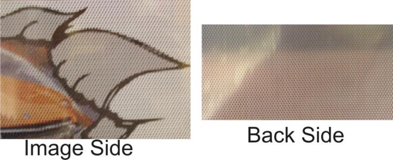

Here's a test of summa perf simulation on clear!
signage
No problem! That is mounted on the inside of the window, so it is actually done in reverse! That is another advantage of doing it that way!
