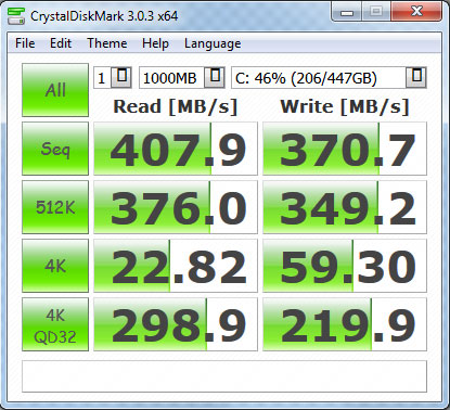

SightLine
Glad you went for it! I mentioned this back on on page 1.....
On adding a PCIe SATA3 controller- I actually did this on my Precision T7500 for the SSD - I bought a Syba PEX40054 card for this purpose. To upgrade to a SATA3 controller. You need a PCIe x4 or higher 2.0 slot to take advantage of this. PCIe 1.0 slots do not have the bandwidth and would see no real benefit. Your machine does however have second generation 2.0 PCIe slots (I looked up the specs on yours) though so you could do this. I researched cards to do this with and for the price the Syba card is (or was 6 months ago) the best bang for your buck to do this. If you do get one (not matter which) install the card first with everything as is and let Windows boot up. This will allow Windows to detect it and install the drivers for it. Then you can shut down and connect the SSD to it and boot back up. I'm using the Marvell 1.2.0.1037 drivers on mine with excellent results. With this specific driver on the Syba card Crystal Disk Info reports the drive running at SATA 600 with SMART, NCQ, and most importantly TRIM enabled.
Crystal Disk Mark.... Not the greatest results compared to what you would get from a couple of SSD's in RAID or on a motherboard with the native Intel SATA III controller but still far better than the 280 or so I was maxed at with the on board SATA II controller. Well worth the twenty bucks or so the card cost me on eBay....
