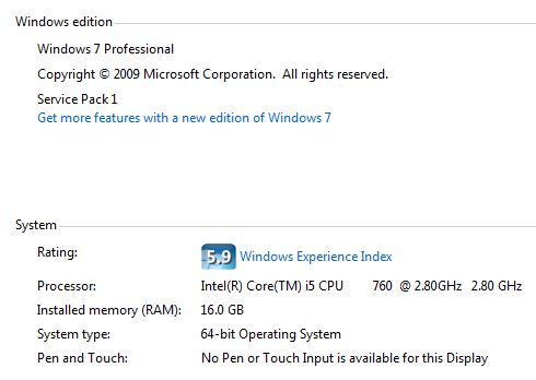

idsignsil
There was another thread about this very issue. X6 has been slow for about the past 3 months. Don't know why, when I installed it it ran very quick. I would have it, AI & PS open and they would all run quickly. Then one day X6 just got slow. I tried hold F8 when I started it, and it did nothing but make me have to go back and redo all my preferences and settings. I was also told to dedicate more RAM to the use, so I dedicated the max, and I was told to open X6 before all other programs. NONE OF THIS HAS HELPED.....X6 still runs slow, and sometimes does not respond at all. I have attached a screen shot of what I am running computer wise.
Joe Diaz, have you had any problems with X6? I figure you being the master you are, would push the program harder than any of us.
